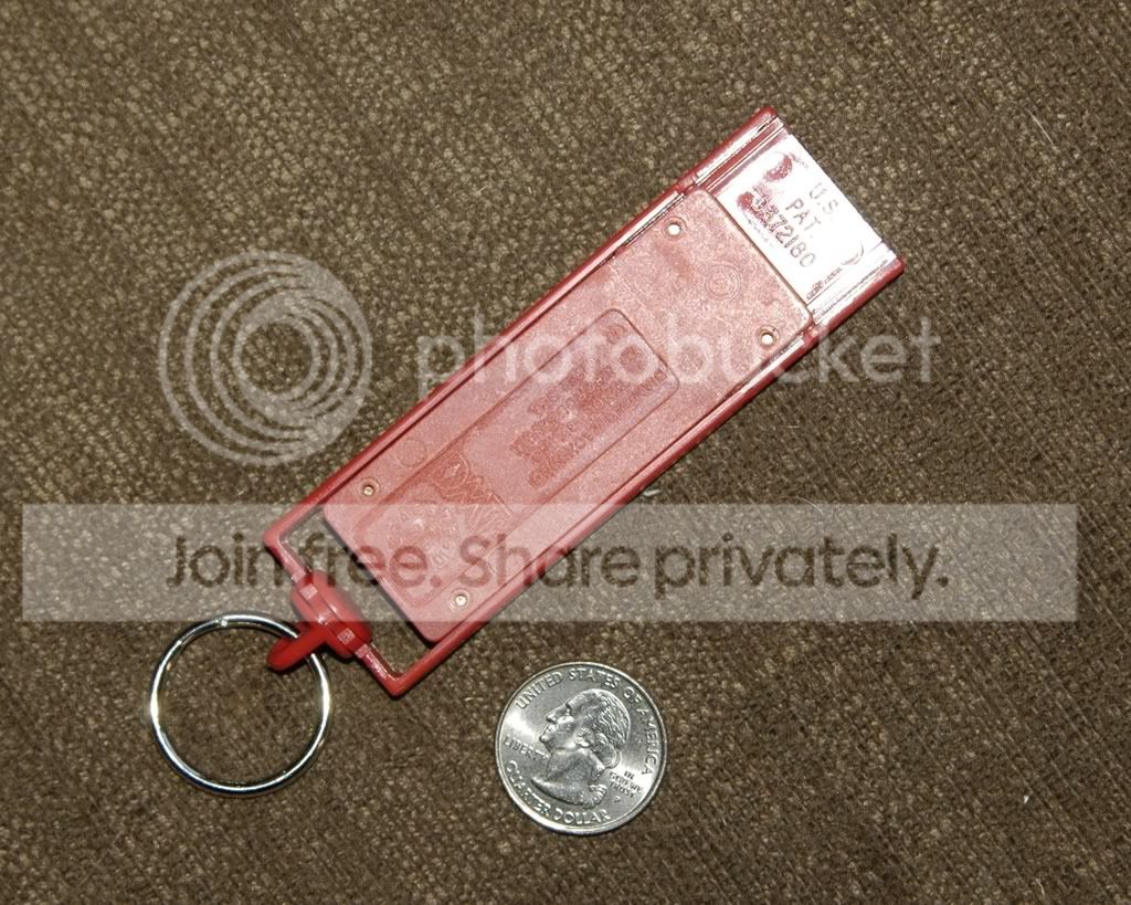

Your better off with a DMT dia-fold http://www.knifecenter.com/kc_new/s...eqCATE CODEdatarq=dmt&eqKEYWORDdatarq=diafold
They make a little angle guide for it too.

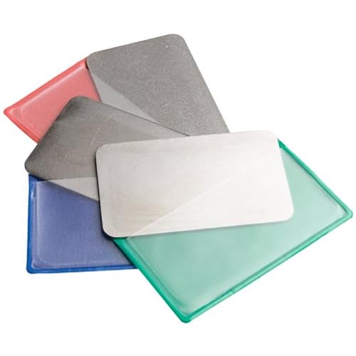

I carry a double sided diamond plate in my minimalist survival kit. They sell at Ragnar's for $17 and are very capable for so light a sharpener. Here's the description:
Two Sided Diamond Plate
If I were starting over, and buying a single tool to sharpen my knives, this is what I would get. It has a medium surface on one side and a fine surface on the other. It's 4" long, 1 1/4" wide, and less than 1/16" thick (.055"). The plate and it's plastic sleeve weigh about 1 1/4 ounces. Made in the USA. ($17)

I love the DMT Mini-sharp. Small and weighs next to nothing :D

i have the credit card DMT but don't like them too much because you can't hold them so that your fingers are below the sharpening surface...basically this means that i'm always in danger of clipping a finger tip off while sharpening.
if you have a good way of holding them or glue/tape them to a base they work great for such a small size, and the shape makes them great to toss in a wallet for a backup.
