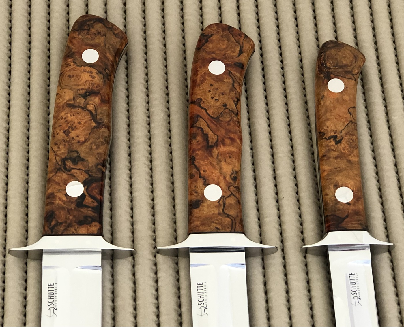

Below are three knives made by Neill Schutte from the same piece of stabilised burl. These are just as nice and will maintain their figure and colour longer than I will be on the planet! It just seems way more practical.
