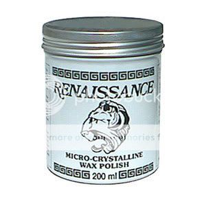

I haven't tried Eezox, but I have been very impressed and happy with results with Renaissance Wax. :thumbup:
Where is the best place to buy Ren Wax? I did some web searching and found a few potential sources, but...
http://www.restorationproduct.com/
http://www.woodfinishsupply.com/RenWax.html
http://www.knifeart.com/renaissancewax1.html
http://www.woodcraft.com/family.aspx?FamilyID=3235
... which one? Actually, as I post this, I see Woodcraft has a $5 off sale.

The going price seems to be about $25.00 for the 200ml can.
I bought a can a couple of years ago and that seemed to be the case then. I searched hard and found a "deal" for about $22.00 + shipping.
That price at Woodcraft is likely going to be hard to beat.
I have even checked ebay and typically see it at about the $25.00 - $28.00 prices for a 200ml can.
DLT Trading also carries it at $25.00: http://www.dlttradingcompany.com/index.php?cPath=224&osCsid=a61a2b419280790e9a747c577fca84c1
A 200ml can will last a VERY LONG time though. So, per knife, that $25.00 can is still extremely cheap. It doesn't take much wax per knife and it is almost as easy to use as grease - you just rub it on, let it dry for a couple minutes and buff off. It buffs easily and very "Clean".
The main reason I like Ren Wax over greases is that Ren Wax is not messy. It feels clean to the touch and doesn't smear, smudge, fingerprint, and make the messes that grease make all over everything.
I am sure that some of the greases mentioned are great for protection as well, but I tend to handle my knives a lot and I like that I am not always getting grease on my hands and everything associated with my knives. :thumbup:
Also, even the can has stayed clean and easy to deal with. Ren Wax is fairly potent when you open the can and use it - like some car waxes, but the smell dissipates quickly and is contained in the can when closed.
Whereas many types of greases I have used over the years leak out of their bottles and make messes and have a chemical odor around the bottles along with the leaks.
When stored indoors, the wax is a solid like many other solid car waxes.
I keep it in a storage drawer near my knives behind my desk and never smell it.
If you use Ren Wax, don't get too carried away and waste a lot. To give you an idea of how far the wax can go, I only need about 1/4 - 1/2 as much wax per "large" knife as I use toothpaste when I brush. A sword might take as much as I use for toothpaste. A folder - much less.
