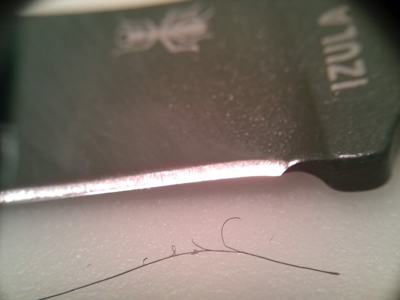

Oh and Yes I agree. Show a pic of your first shaver if ya can.:D
For most touchups, this is all you need.
Yep for the most part, all you need in most places is just a fast hone, then back to cuttin. Good pic. thanks edgy :thumbup:

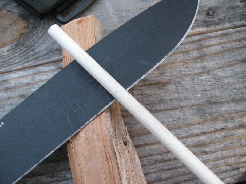

On the Junglas all I have used thus far is a ceramic stick and it is still as sharp as it came. No need to get fancy, unless you have a dull edge :)
