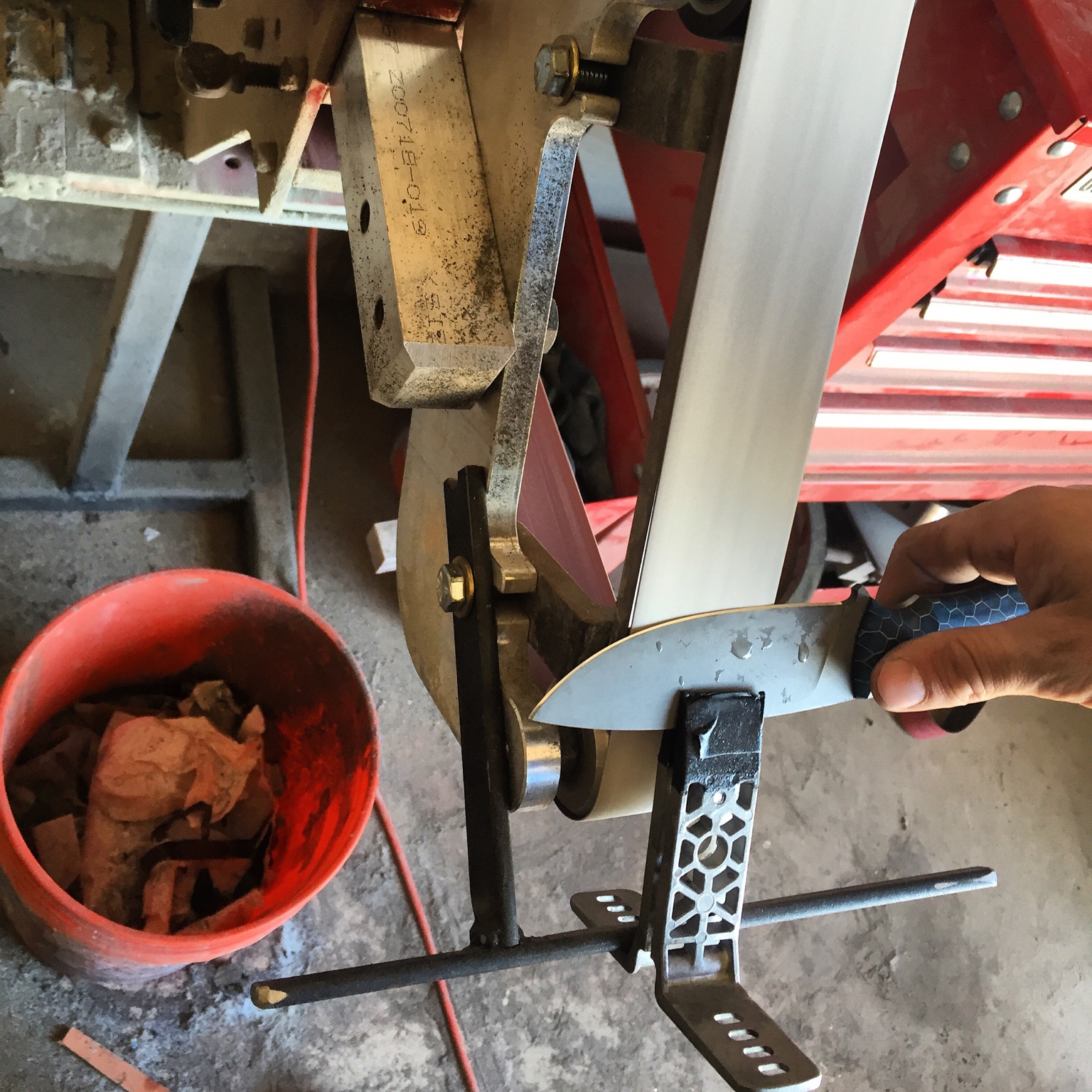

This is what I did. About a dollars worth of 1" steel with a hole drilled in it and the clamp from my lansky. Took sharpening time from 2 hours to about 7 minutes. You could use it against your platen, wheel, or slack belt for flat, hollow or convex grinds.

I suppose they may come in different angles/thickness. But, in reality, the angle they make is fine for almost all kitchen slicers. Just clip it on right up to the spine and sharpen.
The biggest thing that it changes is the language coming out of my mouth. With accidental scraping of the upper bevels virtually eliminated, I curse a lot less.

I'm going to give one a try. I usually set my bevels on my grinder and finish them on stones. I guess I can figure out the angle once I get it so I will be close right off the grinder. I would like one of the ERU's Fred has one day.
