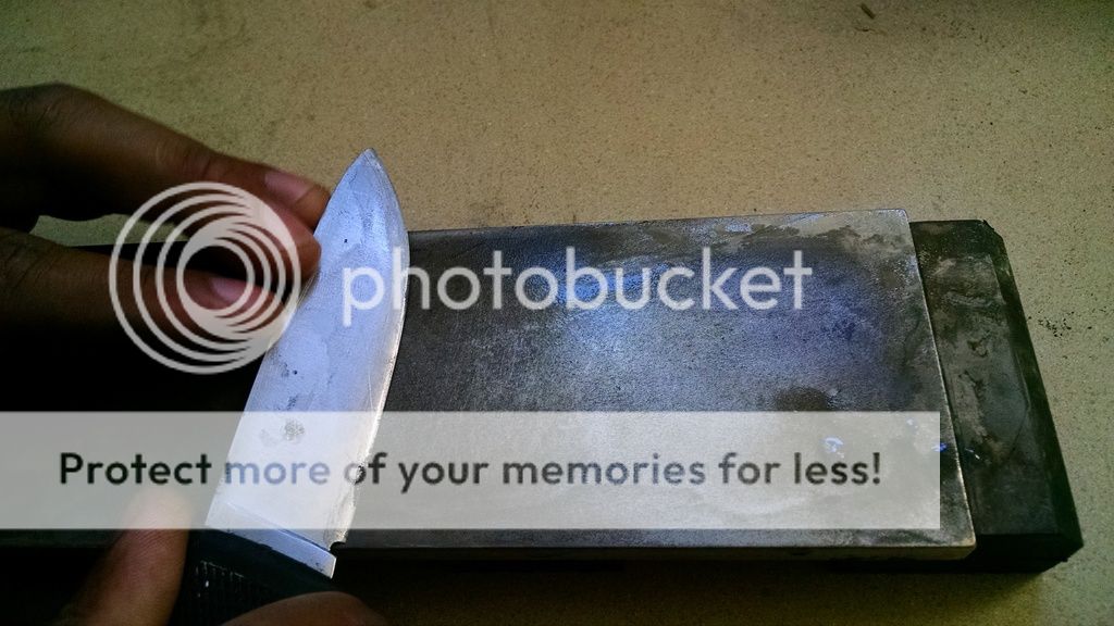

Hi guys, I've got kind of a related comment,
just something you're probably aware of thats worth mentioning,
non-flat geometry can produce high pressure on a stone
I tried grinding a short folder with deep hollow
very small contact points on stone made the norton economy slurry heavily instantly basically just wasting grit
I imagine a soft bond waterstone like the king 1000 would have crumbled in half :)
the dollar tree hard stone took about 10 times more force without issue
I even loaded it with slurry from the norton economy :)
I wouldn't be working toward high levels of force on a stone as a SOP even if you aren't seeing big negative effects. The contact area of pretty much any V bevel will be very high relative to applied pressure overall, especially if it has a notable belly. Will be tough to get the best out of the stone in terms of finish, tough to deburr cleanly, tough to keep the stone in good shape.
Imagine what only a pound of pressure applied with your hands works out to when applied to a 2mm x 1mm area on a thin cutting edge. Amount of force should be as light as possible unless working hard on a stone that's a bit too fine for the task, and even then that only applies to waterstones and vitreous stones and should still be moderate. Even diamond will either glaze or have the diamonds tear out. Is better practice to use a more coarse abrasive and or increase one's hand speed if one is available.
The King 1k is a pretty stout stone all in all. It will groove if worked in one spot, so should be moved around, but that goes for all stones really, if just to spread the swarf around. Is not the fastest but is a nice reliable and inexpensive stone.
