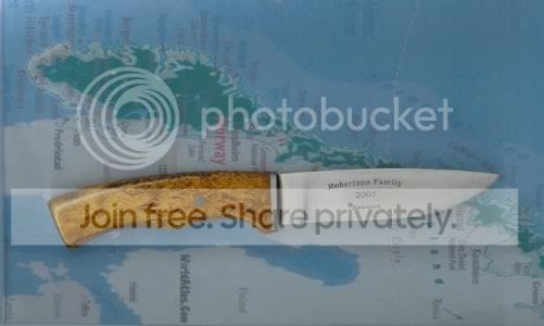

What is best coloring option for wood handles as Masur Birch etc?
Do I need to buy liquid stain or will it be better to buy stain powder and mix it out with water, alcohol or oils?

Ive seen the end result from using home made stain out of a little ferric acid and rusty nails the rust bleeds into the birch or maple in some auesome staining. Get a recipe from one of the guys here it would be fairly simular to the knife with the leather dye.

Not sure if it works with birch, but dissolved iron darkens tannin-rich woods dramatically.
All you have to do is dissolve steel wool into some vinegar. Rubbing this colorless compound on the wood will immediately darken it. I used it to turn walnut completely black for some picture frames. It's basically free, too.
Thanks Mike I knew some one had the thread some where. I have over 100 board ft of maple I think ill try it out for the hell of it. Vinegar and steel wool sounds good too.
Will it be a different color if the steel wool is moisten and allowed to rust before dissolving it in the vinegar?
The idea of the vinegar is to accelerate the rust process. It takes a little while to get it all gross and soupy. The reaction itself is between the dissolved iron and the tannin in the wood. It's colorless until applied to the wood. If your wood has a low tannin content, you can apply strong black tea to the wood in advance. Tea is high in tannin. It's fun to experiment with.
