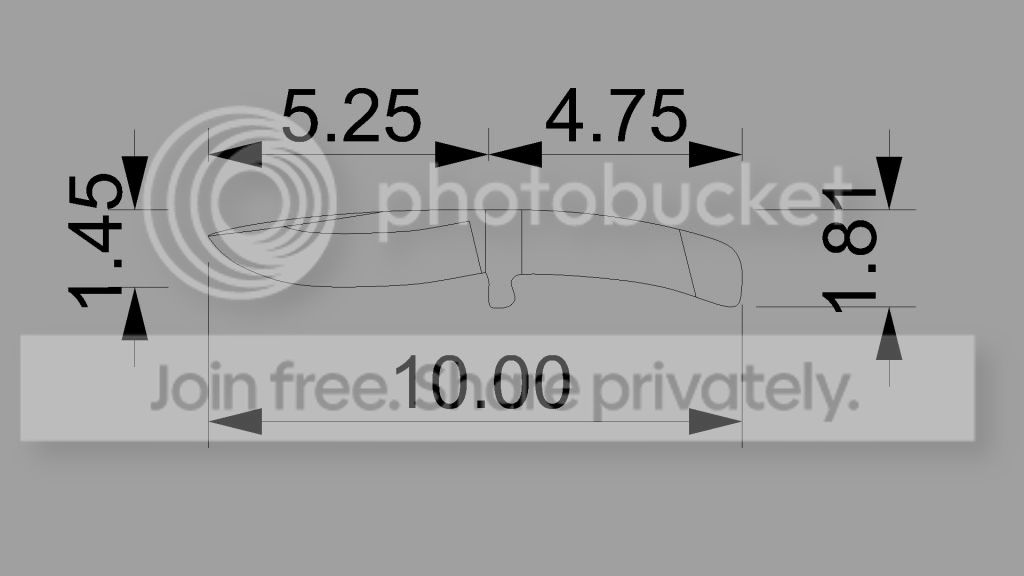

I have my design finalized, more less 9.5" overal length, 4.5" handle, 5" drop point blade. Brass bolster, pummel and rivets. Blue/black denim micarta scales.

Well here is the design I came up with
And a 3D mock up of it
After seeing the mock up I am going to change the guard to look more like a flipper and loose the brass over it, so that if I go ahead and make the matching folder they will be more similar looking. I didn't try too hard to make a good micarta texture but I will in the future.
Next images will be of some test runs on a scrap piece of steel I found, Feel free to give suggestions. My design is highly infulenced by a Lloyd Harding knife, I just really liked the constent curve from the but of the handle to the tip of the blade.

Looks like a nice design.
What I would do is straighten up the plunge cut because if you're sharpening with a stone, the stone will rub on either the plunge line or on the guard. Second, on the handle, I'd cut in for the index finger and widen it from there. As it is, it looks narrower at the back end tan the front which could cause issues with slippery/tired hands.
Advice taken, just added a choil, and I modified the gaurd. The handle is actually a constant width front to back, the 3D image makes it look like it thins out to the back and I will try it that way for now. As I said I am making a rough sample out of scrap steel and I can always take material away to make it feel right before jumping into the good stuff. As it is the cardboard cut out feels good in the hand, but the finger cut out may improve the feel. Only time will tell.
EDIT: I added the finger cut, and straightened the plunge cut and added the choil. It looks good so I am rendering a new picture and will post in a few minutes. Computers make design work so easy
