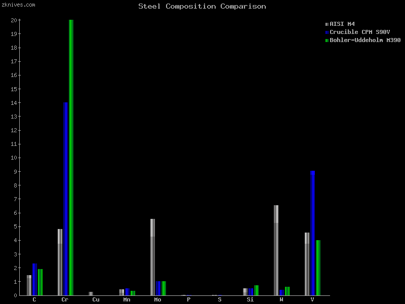

I've actually been curious as to why S90V never got as popular as it should have. It seems that M390 and the like have taken over as the steel du jour, and I've enjoyed the knives I've had in it (currently just one in 20CV), but it seems the only advantage it offers over S90V is corrosion resistance which I didn't think was an issue with S90V anyway. Perhaps ease of sharpening? But you're not going to be sharpening M390 with natural stones anyway, so... I don't know. I've yet to try S90V out myself, but there haven't been a lot of recent production models to try it out in.
M390 is popular for many people in the know as well as S90V, however, I recently spoke to a maker that uses 12C27 hardened to above HRC 60 and his costumers where complaining that they could not get it sharp on a Lansky and the steel was too hard. How would they complain on things like M390/S90V?
If you look at S90V it is quite a different animal than M390 chemically wise (see image below). Higher Alloys steels are also a bit more problematic in heat treating and can do some od things. I know one maker locally that uses M390 extensively and recently used S90V. Was not impressed with S90V's difficulty to grind post heat treatment, resistance in satin finishing and its performance above M390. Another maker is not impressed with M390's inconsistency in heat treatment response above 12C27. Both of whom are very strict in their approaches and heat treatment with several thermal couplings on their furnaces etc.
Of coarse, opinions and experiences differ but these experiences I feel is why a lot of "modern" steels in the knife industry never become too popular.
That might explain why there's a bit of a variance in M390 field reports.
