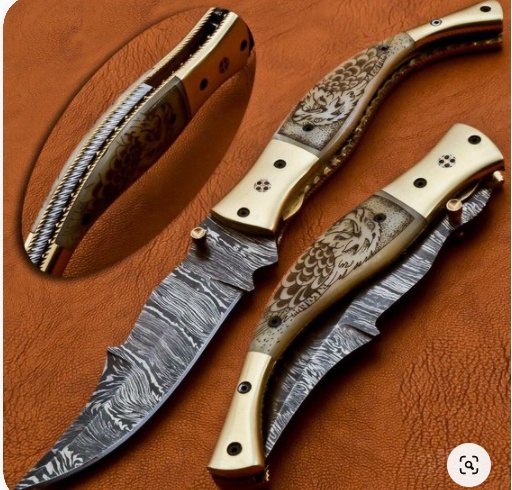

I think i explained myself wrong. Im gonna share a picture of what im looking for. I leave a link here because i dont know how to upload a picture.
First thing that leaped to mind after seeing that is the Lionsteel Gitano in Nialox. Not nearly as fancy as that but similar in style and well reviewed.
I dont need a concrete model. Im asking for the blade because it is gonna be custom made.
Ah, now I understand. Custom, very nice. As a start, decent stainless (in no particular order) would include S30V, S35V, S90V, CPM-154, 440C, CTS-XHP. There are many others, and some people will take exception to my list, but it’s a start. And as jfk1110 mentioned, some makers work with certain steels only so we must factor that in too. Settle on a good maker and they might be very helpful in making your final choice.

CPM-M4 is not stainless!
I would also add S110V, AEB-L to the list. Two very different steels.
Ah, now I understand. Custom, very nice. As a start, decent stainless (in no particular order) would include S30V, S35V, S90V, CPM-154, CPM-M4, 440C, CTS-XHP. There are many others, and some people will take exception to my list, but it’s a start. And as jfk1110 mentioned, some makers work with certain steels only so we must factor that in too. Settle on a good maker and they might be very helpful in making your final choice.
Thank you so much. Thats what i needed.
