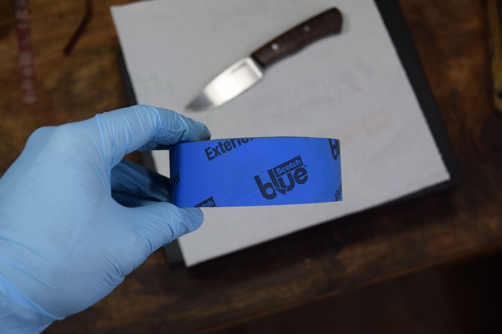

This is the stuff I use when I need to apply tape-to-steel, which I try to keep limited as I work mostly with carbon steel as well. Scotch Blue Exterior. The cheapest I've found it is through Amazon. It isn't a paper based tape like most. It adheres really well and leaves little-to-no residue behind when removed. I've found it doesn't promote corrosion like the other paper-based masking tapes I've tried. Like most of the others though, when I can, I apply heavy mineral oil followed by phone book paper and then wrapped in electrical tape.
