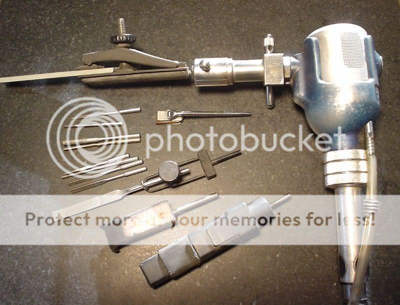

What i have in the box is most likely the best thing since sliced bread. can any one guess what it is. I will give you a few hints. It plugs in, and i will use it to do do things to my knife blades to dress them up. it also can be used in fitting guards and other requirements that require removing metal. I probably gave it away but lets see if you can get it. i will post picture of what it is in a little bit. but until then see if you can guess.
Well since you where so close I will post the pictures.
Have you guessed what it is yet;). It's an electro file'er-O-matic. Well that's what I call it. It will hold any swiss files and with the press of the foot peddle the file starts filing :). The speed as well as the stroke length is completely adjustable. also in 2 pictures I'm holding it and my pointer finger is resting on a squareish finger rest. By moving my finger up or down I can rotate the file. This allows for really nicely blended cuts like File work on knife spines ;)

Mine is marked "The Diprofil Machine"
Made by Normek AB in Sweden
How do I change the stroke length?
Under the vented cap there is an adjustment. If you ever want to get rid of yours let me know and I will buy it off your hands. It would be very handy to have back up parts.
The Foredom motor has a 3:1 gear reduction head on the angled side. If you ever want to sell IT, let me know!

Diprofil ........ It isn't so much an "electro file'er-O-matic" as it is a tool used in the Tool & Die Industry for polishing injection mold cavity. You'll get much more use out of it if you purchase stones & stone holders.
It will save you a LOT of elbow grease when polishing your knives.
Here's a hot tip ....... or should I say a cool tip :cool: Add a cooling hose to the little tit coming off the handle of your unit, then run it to an air source to keep the Diprofil at a handle-able temperature. You will be surprised how warm (HOT) the tool can get when polishing :eek:
