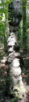

I have a cherry tree on my property, the trunk is roughly 8-10" in diameter and then it swells to 14-17" into a burl about three or four feet off the ground, and then resumes its original diameter of around 8-10" above he burl. First, I've never seen a burl so uniformly formed in a tree, the ones I've seen typically look like a growth coming out on one side or the other. I'll take pics before I cut it down.
What is the best time of year to harvest a tree to use for scales/handles? Would you want to wait until winter to let the sap "fall", or cut while it is in it's active stage?
I Know I won't be able to use this for some period of time (I've read a year for every inch of thickness of board/slab), but thought it would be neat to build a solar kiln and take something from harvest to knife.

Cut it in the winter ... around January. Cut it a good foot from the bourl part. Paint the cut ends and 6" up the sides on both ends. Set it aside in a place that gets good airflow, but out of the rain to dry. Let it dry a couple years and then cut the burl in half down the center to see what it looks like. From there you will decide how you want to cut it up. Cut large blocks/pieces and let them dry for a year, then cut into smaller blocks and dry another year. It should be ready to cut into slightly oversize handle blocks then. Cut the blocks and let sit for 6 months until the moisture content is below 10%. Have the handle blocks stabilized.

If you post a photo we might be able to figure out if it is a true burl -vs- a bunion. A burl will have small points that are dormant shoots. A bunion tends to be swollen growth.
Burl will have eyes showing in the wood. Bunion will have swirly grain.
@Burl, that's interesting, never knew that. I'll try to trek back there this weekend and get a pic. If bunion, is it worthwhile?

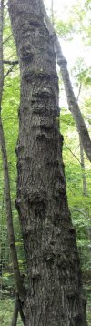

Just went onIMG_20170813_121854.jpg IMG_20170813_121854.jpg IMG_20170813_121804.jpg an interesting walk, found a good number of gnarly-looking trees. I don't have the expertise to determine which, if any would be likely candidates. Maybe the experienced folk could chime in on the pics. The first 3 are the wild cherry I mentioned from different angles, and the rest are maples

The two larger maples would give me some nice wood for solid wood furniture and the pieces would be large enough to show some interesting grain patterns but I'm not sure they would be suitable for knife scales/ handles.
The largest maple is 3'+ in diameter
