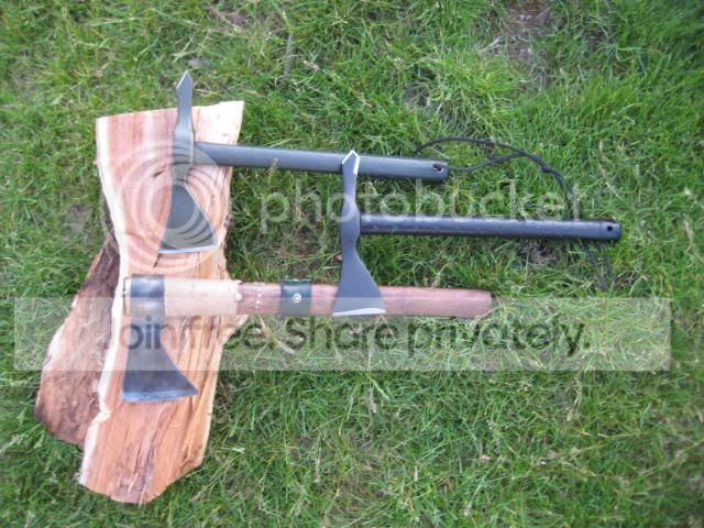

These are 3 of mine, but I am not happy with the Lagana price and performance over the Cold Steel's version.
