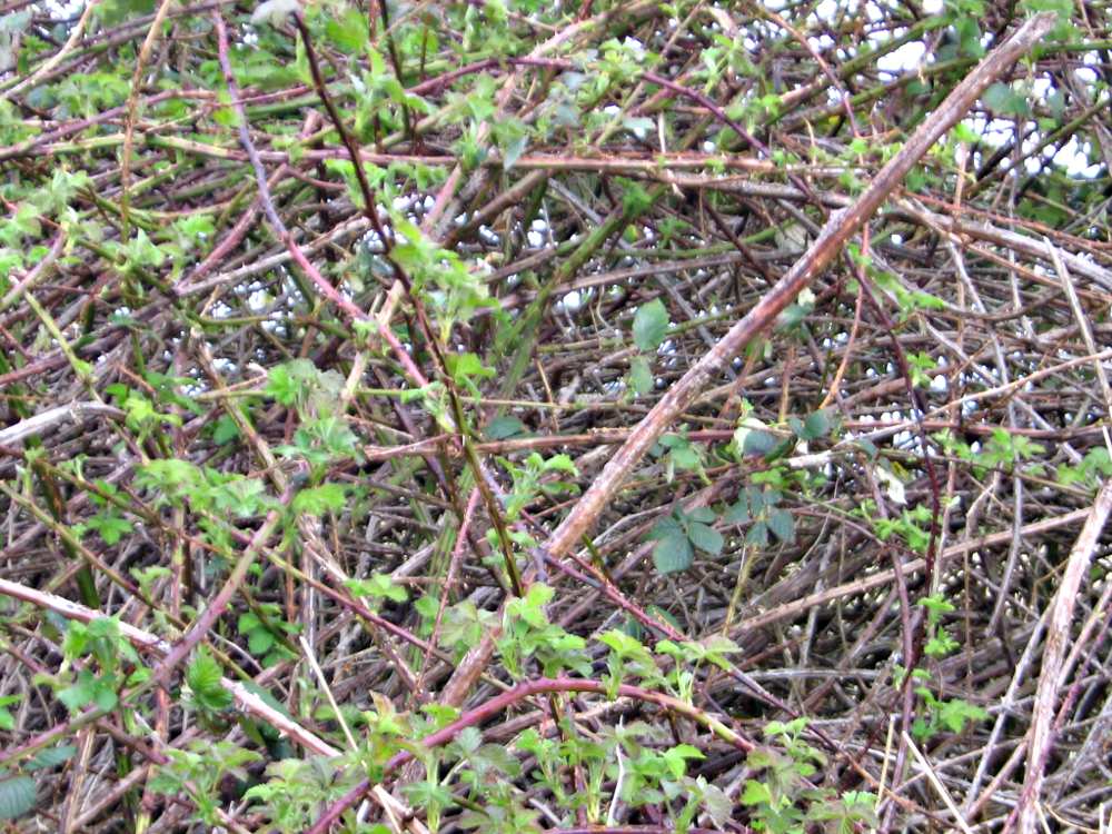

Oh, I meant to update this thread with the results of what I actually ended up doing, and what I thought about my tool selection, the whole experience, etc.
I ended up buying a 24in weighted imacasa machete for my task. In hindsight, I may have wanted a bit longer and lighter machete for the areas that were more pure blackberry, but the "longer-ish" 24in weighted machete did pretty well on the saplings, and few small trees I ended up taking down. I figure the area I cleared was probably close to 1/8 acre.
Learnings/observations:
- For these big PNW blackberry, I don't think I would have wanted anything with a hook on the end, unless it was substantially longer.
- I'm not stretching the truth, when I say that areas were ~8-12ft tall (over my head, and couldn't reach with the 30in OAL machete)
- Green blackberry canes weren't an issue ever, at least with this tool. They (and ferns) are pretty darn easy to cut.
- Dead blackberry canes were much more picky about the angle used, and the blade speed. It was mostly because of the areas with huge clumps of dense dead blackberry cane that I considered buying a lighter 28in latin pattern machete (never did, but considered it).
- If the machete was dull, you hit the (dead) cane at the wrong angle, or your tip speed wasn't high enough, it would sometimes pull the canes instead of cutting them, resulting in one cane pulling around the back of my neck like a chain on a chainsaw bar, instead of cutting cleanly.
- Saplings of < 1~1.5in I could generally chop down in one stroke, occasionally two.
- Saplings > 1.5 < 3in or so were just a few strokes to take down.
- I could take down whole groups of saplings < 1in in a single swing, easily
- The largest tree I took down with it, was maybe... ~6- 7in or so in diameter (guessing, from memory of this happening 3 months ago). It wasn't ideal in that situation, but it didn't take long enough to worry about hiking up the hill to go find a more appropriate tool.
- I learned its easy to prevent the machete from sticking/binding in thicker wood by just not swinging as hard.
- Large machetes are absolutely amazing at limbing downed trees/saplings.
- If I'd been trying to cut things even with/flush to the ground, the machete would be much more frustrating to use. I was glad my game plan was to rip out the roots with an excavator instead of trimming them flush, or digging them out by hand.
- A bank blade or the like probably would have worked, but would have been hard to wade through the denser areas, and been tiring.
- I'm not very familiar with Scythes, but I don't think "I" would have gotten as much done with one in the same amount of time. Way too many larger saplings around, and the area was uneven, and most of it was on a pretty good angle (maybe ~15-25% degree angle).
