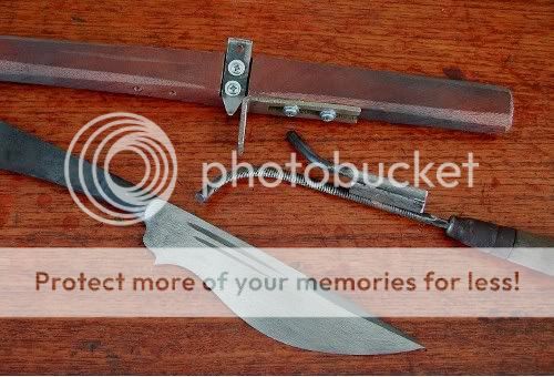

Here’s a couple quickies I made for different things,… just for some ideas. I used the top one for the lines in the blade pictured. All you really need is a "bit" of some kind, a way to "hold" it, and a "guide" bar.
