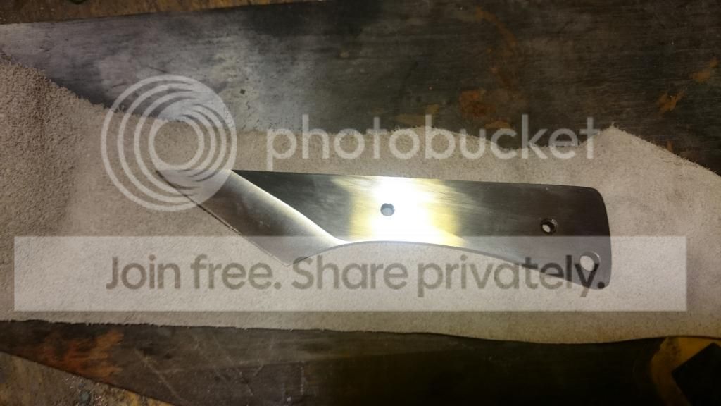

im not saying this is a great idea but if you use several types of carbon steel you could make "fossil Damascus" in a canister. if you wanted to.
Get three pieces of some thicker chunks of scrap (say 1/4" thick by 3" long and 1" wide) and stack in up into a san mai billet, then forge it down and draw is out and you could easily have enough material for a san mai necker etc... or do the "scrapmascus" thing, except without the tube and powder (canister).. Just forge weld a bunch of seperate stacks of 4 or 5 (or more etc.) layers, forge those down, then take all of those and stack them up and forge them out and you can easily end up with enough material for a smaller knife.. Plus it will be easier to do with just a hand hammer.. Just my two cents :thumbup: :cool:
~Paul
My YT Channel Lsubslimed
This!
So I'm thinking 2" pipe or something like that? and probably should wait till I have access to a power hammer.... What about voids, any tips on cutting out the chances of air voids in the billet?
The best way to avoid voids is the use the pour the metal powder as you are layering in the scrap. Also tamp it often and they for a while at the end to make it settle as much as possible.
The second important thing is to have the material sealed from oxygen, typically by welding it shut. If oxygen is not present, when you are at forge welding temps, the voids will close and weld shut when you forge the billet down to size.

Well it appears I have plenty of experimentation and playing ahead of me. Def some great advice here. Very nice kiridashi and I would also like to see some of Nicks tools he makes from scrap. I really like seeing all the one off custom tools he has in his shop, gets my gears turning.
