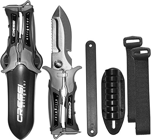

best i dunno, but certainly useful
http://www.cressi.com/catalogue/details.asp?id=923
