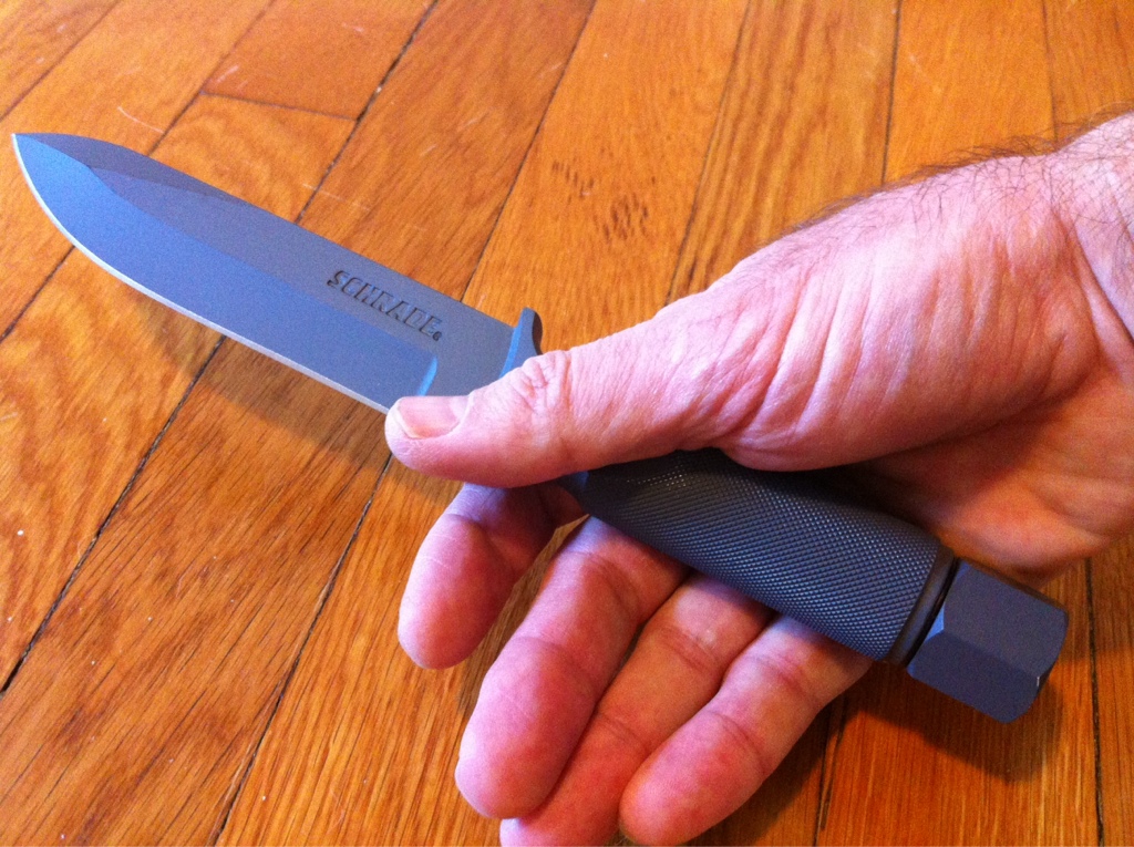

The sandpaper and mousepad trick works really well to create a convex edge, but it takes patience and some trial and error to get a feel for it. Most of the time, I can get a pretty good convex edge simply by starting with 400 grit wet-or-dry paper, then going to 600 grit, then stropping on a leather strop with white rouge. This is my quick and dirty method, although I know other people like to use a much wider range of grits. And it does depend a bit on what blade steel you're dealing with. But this works for me.
Sometimes more drastic measures are required. I recently put a convex edge on this relatively cheap Schrade "survival" knife. It came with a rather "fat" secondary bevel that made fine cuts almost impossible. There was a kind of square, fat shoulder where the secondary bevel began. I took that down by doing some hand work with a file. I tried to be very careful to only file down that "shoulder" and not touch the cutting edge itself. Then I did the mousepad method as described above. It now filets paper and shaves hair very nicely!
These aren't ideal comparison pictures, but anyway ---
Before:
After (also showing fancy new white vinegar patina):
