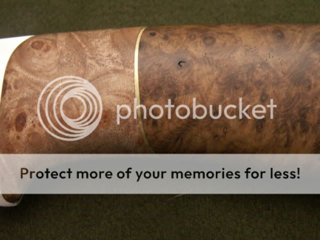

These pics are some info to Mike Krall's question about stabilized wood looking plastic. Although in neither pic I am using walnut at the time, you can see the difference between unbuffed and buffed. When I buff handles I do not use any buffing compound at all, only a clean flannel buff. I had a blade with stabilized walnut burl on it that I finished with about 5 coats of teak oil on it, and it looked like the second blade.
Here is a piece of stabilized birch sanded to 1000, 0000 wool and oil, and buffed. Looks like plastic.

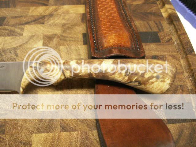

This one is stabilized maple and teak burl. Sanded to 1000, 0000 wool and oil, no buff. I did not fill in the inclusions on purpose.
gixxer,
Pictures worth a lot! I think that may be the first time I've seen stabilized wood that didn't look like it was made of plastic. Thanks a lot for doing that.
Mike
