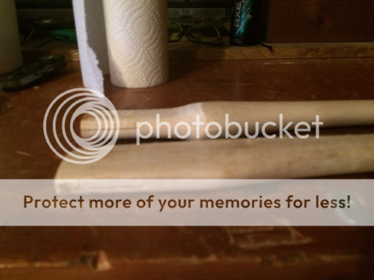

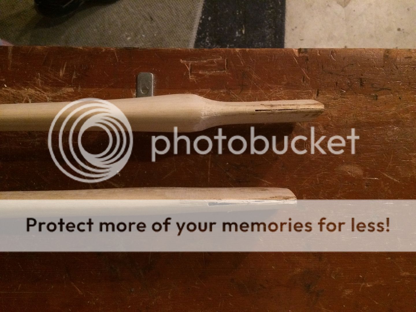

I have two boy's axe handles sitting on my workbench - one a Link with no shoulders and one HH. There is a noticeable difference in mass for sure. I'll try to get a picture this morning.
You can order a boy's axe handle and a 28" full-size handle for comparison - which ever you don't use for this hang, you can use it for another project.

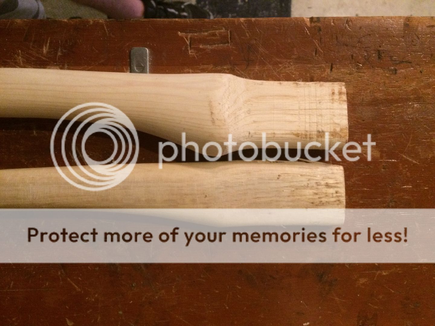

Here is an example of a Link handle compared to HH – both are “boy’s axe” size.
They are both 28”, one looks longer than the other in one picture as I had them propped up on the foot of my vice for the picture.
My wife also likes to put things out on the workbench to send me a message. She text me she bought me an axe and put it on the workbench. She supports my endeavors…
Thanks for the pics. Yea my link handle looked just like that. The HH one is on top right? Hopefully that will work, as I only needed a bit more meat in the eye for it to be a good fit. I think I will do that, order a boys axe handle and a full SB handle.

Glad the picture helped out. The HH handle is the top one like you noticed - that one was with no varnish so you might end up with a touch more meat to work with if you don't ask for that and remove the varnish yourself.
