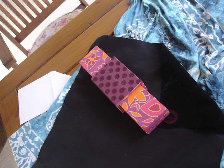

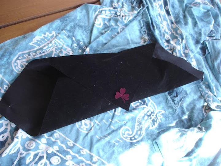

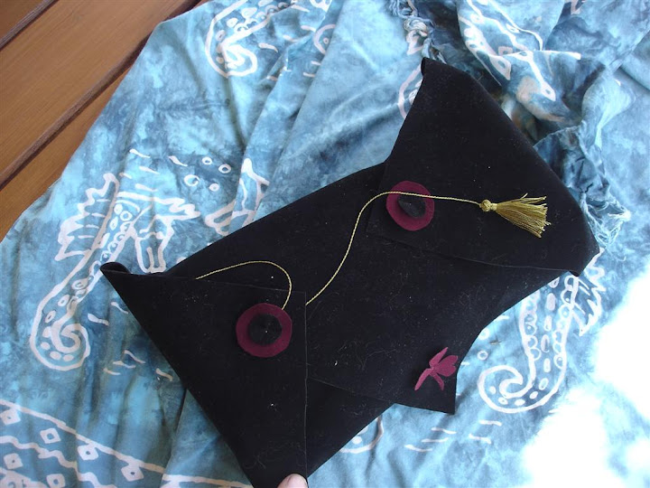

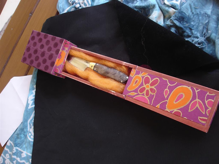

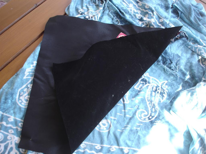

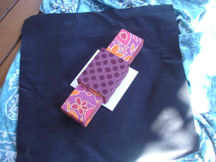

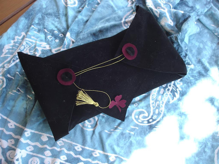

My way of packing is inspired by Japanese froshiki techniques. It is hard to explain, so here are the pics: (boxes are covered with japan or indian paper, filled with natural dyed wool, froshiki wrap is velvet)...
Emre
That is a beautiful way to package knife Emre, but I don't think the postal service would like it, no place to affix a shipping label:p Seriously though I understand that would be inside something else. I don't think my knives are at that level yet, but it is an inspiration for when they are
