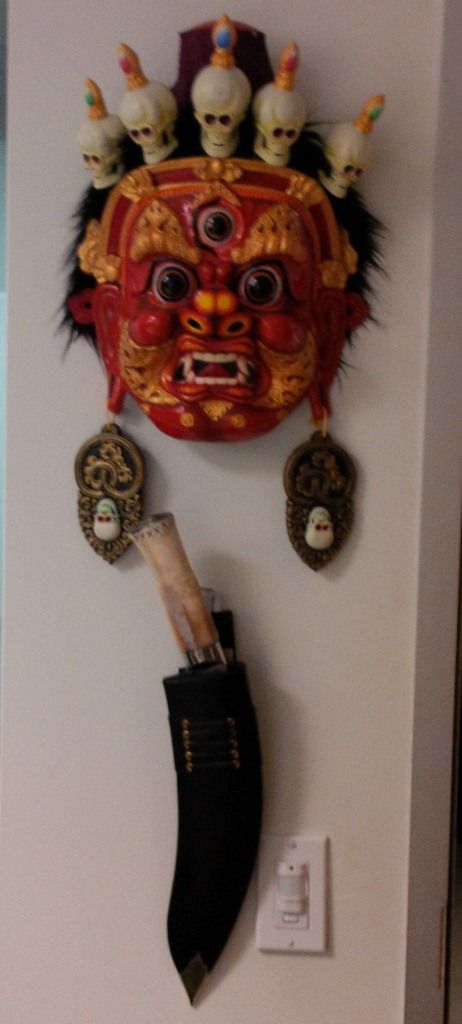

Last week I bought my very first "real" kukri, the 18 inch Vojpuri Knife by Rajkumar. I could immediately tell the difference between it and an Indian "kukri" from the moment I held it in my hand. I used it this weekend to chop up some fallen trees in my parent's back yard. It chewed through them with ease, but I've decided this knife is just too beautiful to be used. I've ordered a KVLUK for actual use, so I'd like to restore the Vojpuri to its mirror finish so I can display it. The blade isn't damaged in any way, it's just scraped up a bit. Is there a preferred way for buffing these kinds of superficial scrapes out?
I've already picked out a good place to display it. This guy seems to have a thing for severed heads, so I'm sure he'll appreciate it.
