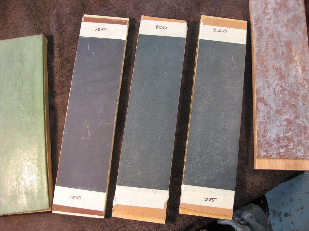

I've found that freehand sharpening with diamond stones and sandpaper works just fine on convex edges. You just have to pay attention to keeping everything even, but it's actually pretty easy. At least, on smaller blades.
This is the setup I use to sharpen my convex knives. Mostly, I start at 1500 or 2000, then strop on white, then green, or one or the other. About the only time I move down into the lower grits is when the knife is getting dull or there are knicks to take care of. Light pressure, low angle, repetition. Same with the strops.
