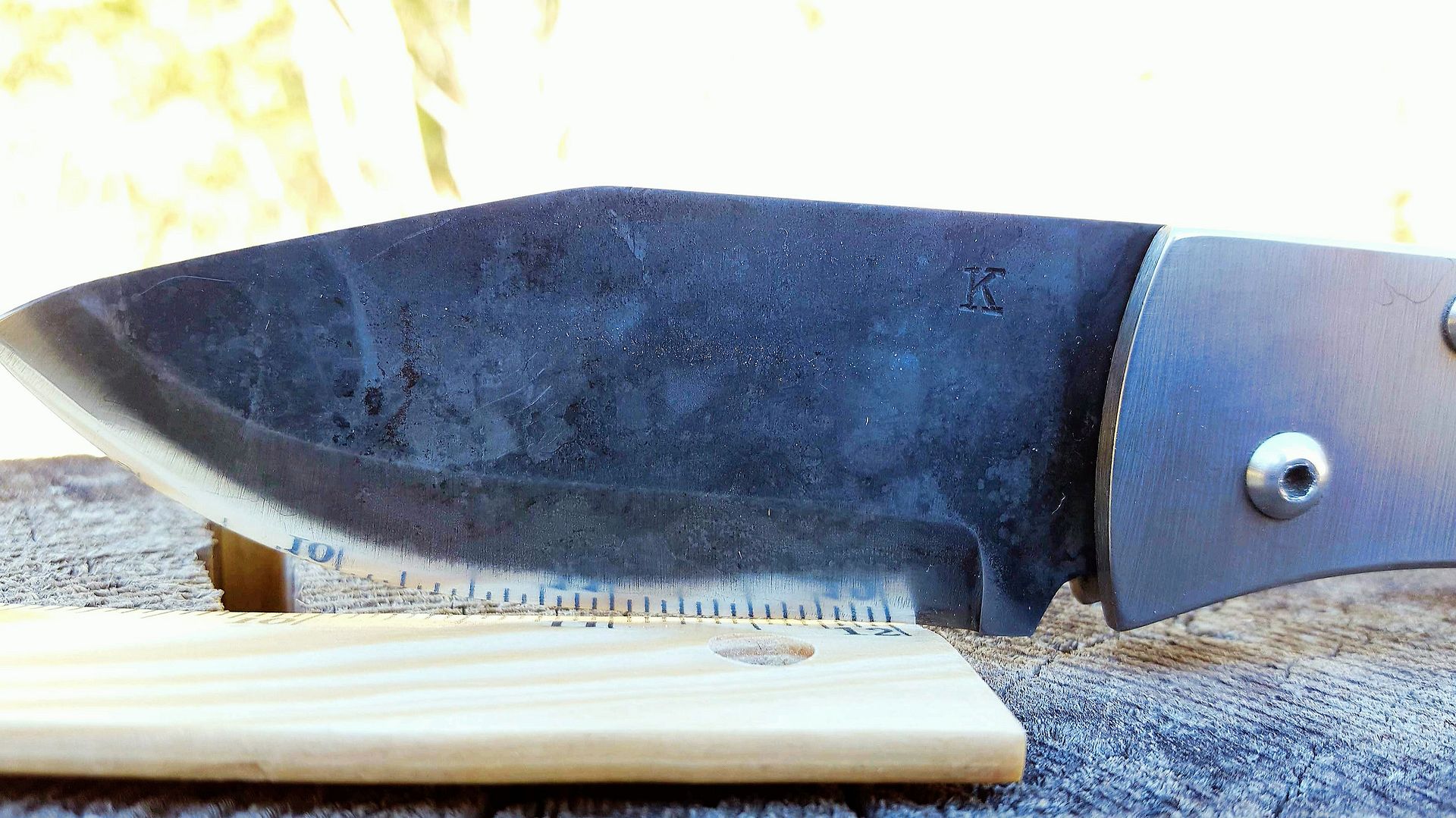

Finally got it to shaving sharp. Not hair popping, but it will do. Took about two hours on a course Arkansas stone, then an hour on medium and one on smooth. Finished it on black leather, then blank leather.

The problem is the knife. The blade grind is wrong.
This is the correct answer, the knife needs a secondary bevel to allow easier sharpening. My thinking is you have not fully apexed the knife because it takes much longer to remove the amount of metal necessary for such a wide edge bevel.
Take a few passes grinding the edge directly into the stone to blunt it, note the light reflecting at where the apex should have been. Then you must grind until all this light has stopped reflecting, actually just slightly more passes than it takes for this. At this point, even off a very coarse stone the knife should be shaving sharp if you have fully apexed it. If it does not do this, you haven't fully apexed and you need to keep grinding. Don't move on to finer stones unless you have achieved this.

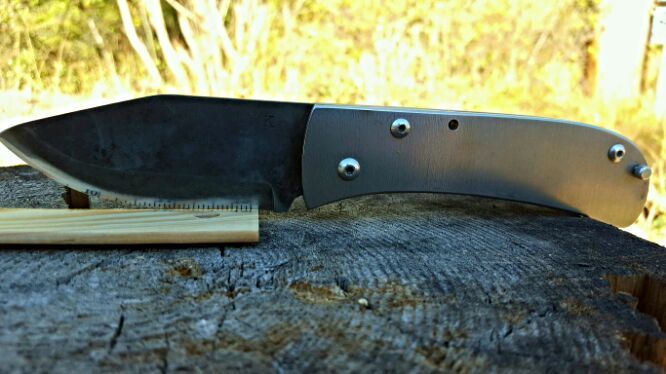

Finally got a hair whittling edge. It took a little over an hour on the fine stone, then many, many more hours on different strops
And look how wide your secondary bevel is!
The primary bevel is wrong on this knife. It's more like a cold chisel. The bevel should be at least twice as wide as it is, and it could actually go all the way to the spine.
As it is the knife is a flat pry bar with a chisel edge.
The secondary bevel is actually shorter than it looks. The stropping took off some of the patina around it, so it looks wider than it is. And I won it in a GAW, so I will certainly not complain. It is a good knife that has served my well this far.
It's kind of hard to see, is that a scandi grind? If so, you'd have to remove A LOT of metal to get to the apex. You can sharpen any steel with anything that's more abrasive than the steel. Maybe your stone is clogged. Take it to the sink and scrub it. O1 is not hard to grind. If you can't get it sharp then you're not hitting the apex and/or not removing the burr and/or rounding the apex when you strop. That's all it really ever is in any of these threads.
The reason you may not be hitting the apex is likely because of the stones you're used to using. They're slow to cut and quick to glaze. Clean them or buy a new set. Try a spyderco bench stone if you're used to freehanding. They're not that expensive.
The reason you may not be removing the burr is because a lot of the steels/knives you mentioned could form burrs that are easier to remove and that's what you're used to. With this one you may just be flip flopping the burr back and forth until it breaks off leaving a rougher, coarser edge. If that's the case sharpen until there's the smallest of small burrs on one side, do the other side the same way, then increase the angle by several degrees and very lightly make a couple of passes on each side to cleanly cut the burr off.
If you're rounding the apex then just keep a more consistent angle and make fewer passes when you strop.
