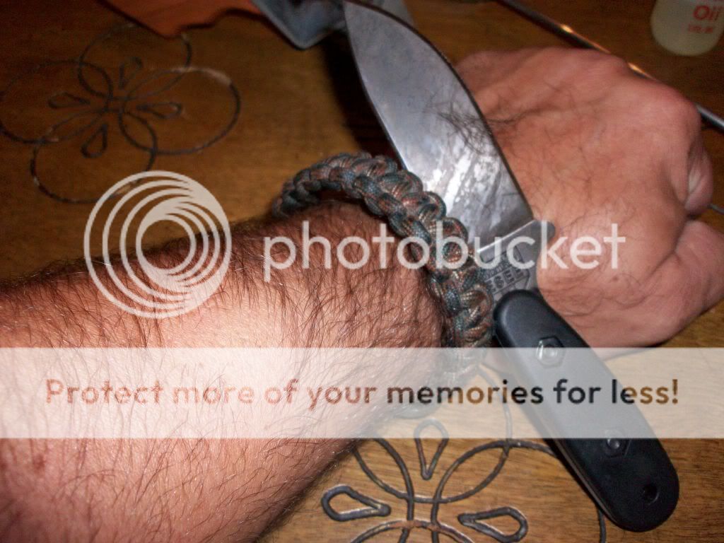

I like to use the "samurair hair test", gently scrape your hairs to feel the catch without severing any hairs, quite handy if you dont want to shave your arms but it is less accurate than thumb testing, i generally use it on random knives that i know arent very sharp.
I use my left arm hairs as a sharpness test field very often so my forearm is quite bald all the time, i keep my right arm relatively virgin and use it for treetopping tests,

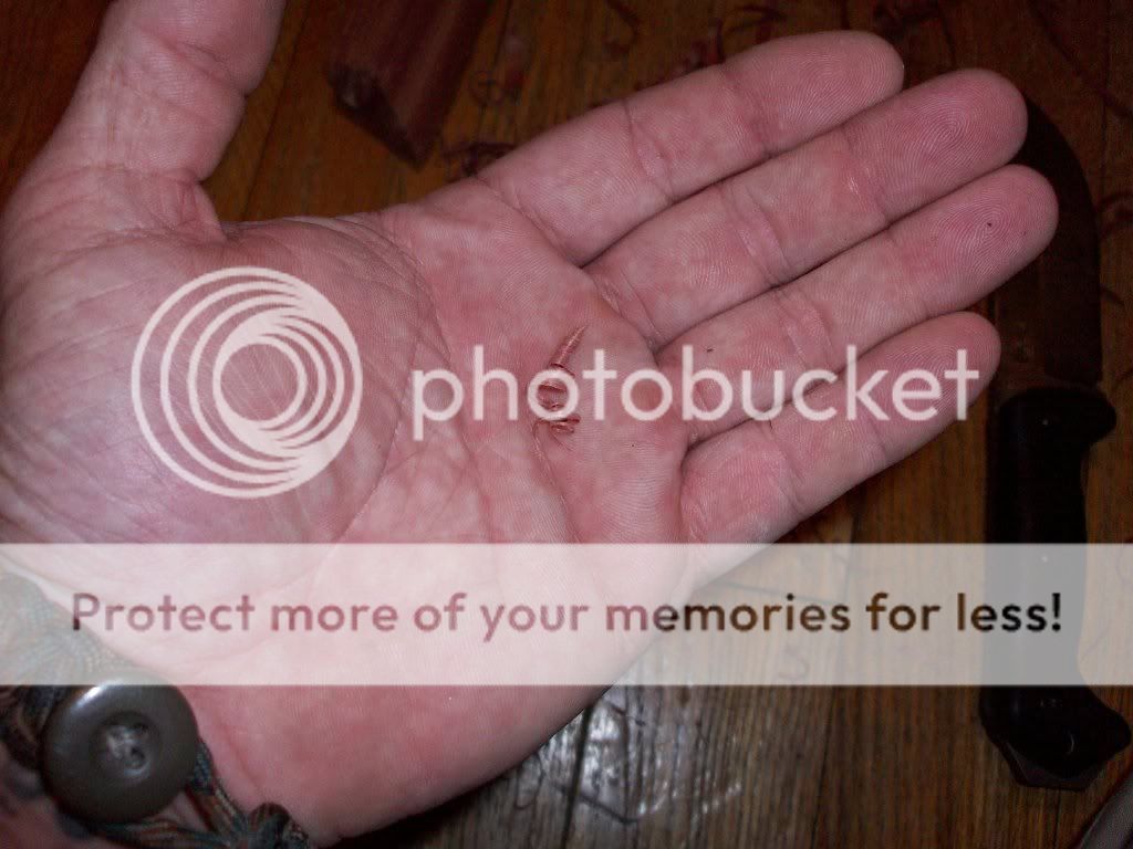

One way i started to use recently is slicing calluses off my palm.
