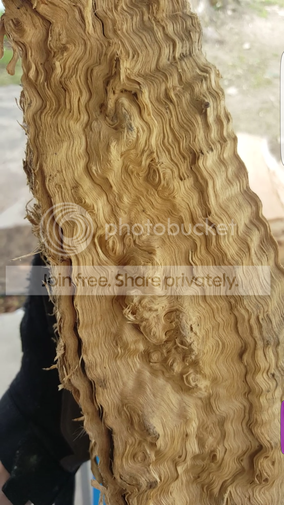

really, I'm just not seeing it.. years of beating the blades I mentioned and I have never seen 1095 hold a candle to my infi beater.., that said the use I put blades through is impact stress in knarly wood...not "slice cardboard" stress..

Very cool blade..and im assuming its blade geometry and design is designed for chopping alone..a comp blade as you mentioned. I was after a bombproof blade when I found Busse.. a beat the shit out of it blade.. the Busse chops, batons, prys, and hammers and stays very sharp though the process.. an maybe "some" 1095 does to..I just haven't seen it do it as well as infi.. and I'm guessing that blade is a pinch more money than the $200 busse alternative..

Yes I'm typically batoning and often need to pry the knotty logs apart.. if I were after a all out chopper, I would go for a blade with more of a machete effect.. like the blade listed above..or a Silverback or something. when I need to clear a jeep trail of branches I don't grab for my busse..I grab my 25$ machete and don't give two flips if it chips an edge.. I have thought about getting a silverback..
