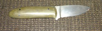

Better ?
Yeah looks better. That point in the handle doesn't look to comfortable but we can wait for more expierence guys to chime in
Maybe it s time for you to try hidden tang ? This one is good candidate for that ?
Knock the point off the back of the blade and the middle of the handle and you have pretty close to what Natlek suggested and a more practical knife in my opinion
I don't like anything to hang down past the cutting edge, like the little spike in the ricasso area. Just seems to be something that gets in the way. Just my preference though. I see it in production knives all the time and wonder why its there.
Yes, something like this .... maybe with pin in scale for lanyard ?
That pointy handle doesn't look comfortable to me but that's just me..
I recommend drawing out all your designs on paper first. Then mock up with cardboard, foamcore, balsa, or whatever else is easy to copy the shape. You can even 3D model the handle shape with sculptors clay, play doh, or styrofoam that you cut to shape. A little preparation makes for a little less perspiration wasted...
I think it looks much better than your first attempt already.
My only advice would be watch out when it comes to finger grooves. They can make it so people with different sized hands may not find the grooves comfortable.
I would also agree to knock the point off the back of the handle and remove that little pointy spurr at the back of the blade. It looks awkward and doesn't help anything.

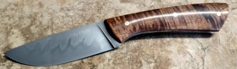

Please don't take this the wrong way (really please don't)..... Slow down, slow down, slow down. In your previous posts you wanted to sell your knives. Quality sells.... You want to make a bunch of knives fast. That might work for a short time but in the long run the buyer's that matter will notice the lack of fit and finish. Take your time and the speed will come. I have only been doing this for a short time, and have to take a deep breath and slow down to give the best I can out of each knife. Watch YouTube videos, read books and pay attention to the quality of work and designs well known makers have. My first knife looked like a prison shank.

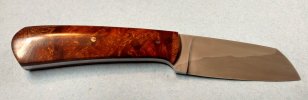

So I read, watched, and steadied as much as I could. It took a month to make knife number 2. It's a horrible design that's not very user friendly.
And knife 23 and 24.

To save your blank, you still need to round the point on the top of the butt .... just round it, not re-grind it. The point sticking down from the ricasso needs to be flat and even with the blade edge .... no spike. The center of the handle bttom should round a bit too ... just slightly round the point to make it smoother.
