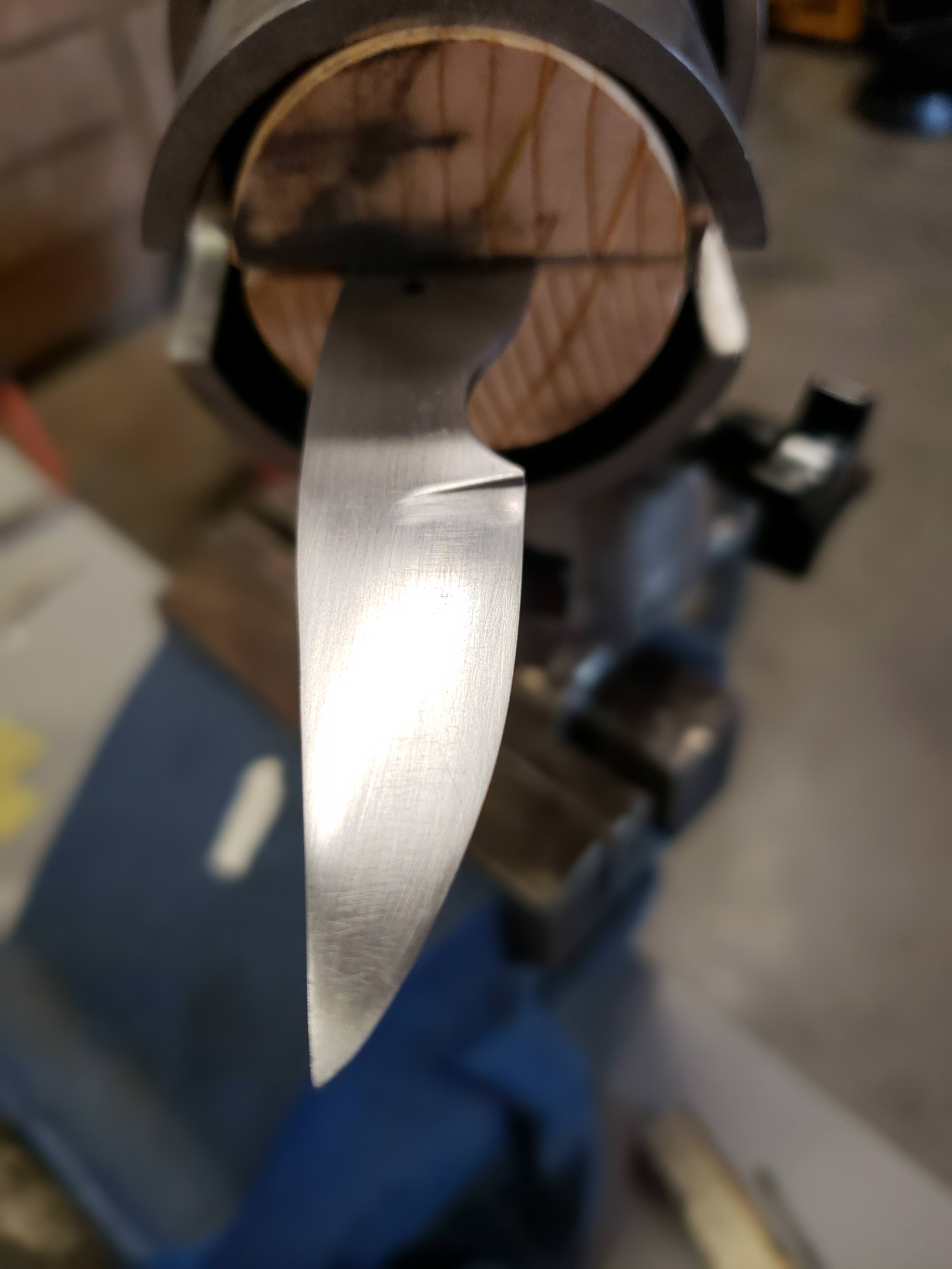

Lots of hand sanding to do still, but the beval is looking better. Don't know if I am going to blue the blade again. We will see
Yes , bevel look much better now .But that tool is not good for hand sanding blade , blade will flex .... that tool is good for sanding handle .So , put some thick flat steel under blade / longer then tip of knife so you can t hurt yourself / or take some angle iron in vice and fix knife on top of that ...........
