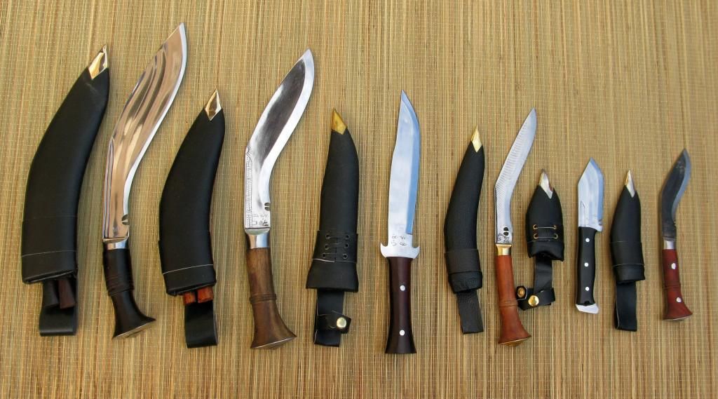

Were I in the market for a fighting khukuri (I'd probably chop my own hand off), or just a great all-around khuk, this darling on the left would be THE contender. It's a Thamar tin chirra at 17" and 21 oz. Those fullers can do nice things to balance and handling. Plus, look at those curves!:thumbup:
I totally agree JDK1... I have a 17.5 22oz Dui Chirra and it is my #1 fighter and favorite kukri of all time. I love the "tree stump' tang and curved handle. It is by far the best fighter I have due to the balance and large belly.
I love my Thamar Dui Chirra as a fighter too, but I still prefer my Rajkumar Bashpati as my goto fighter.
