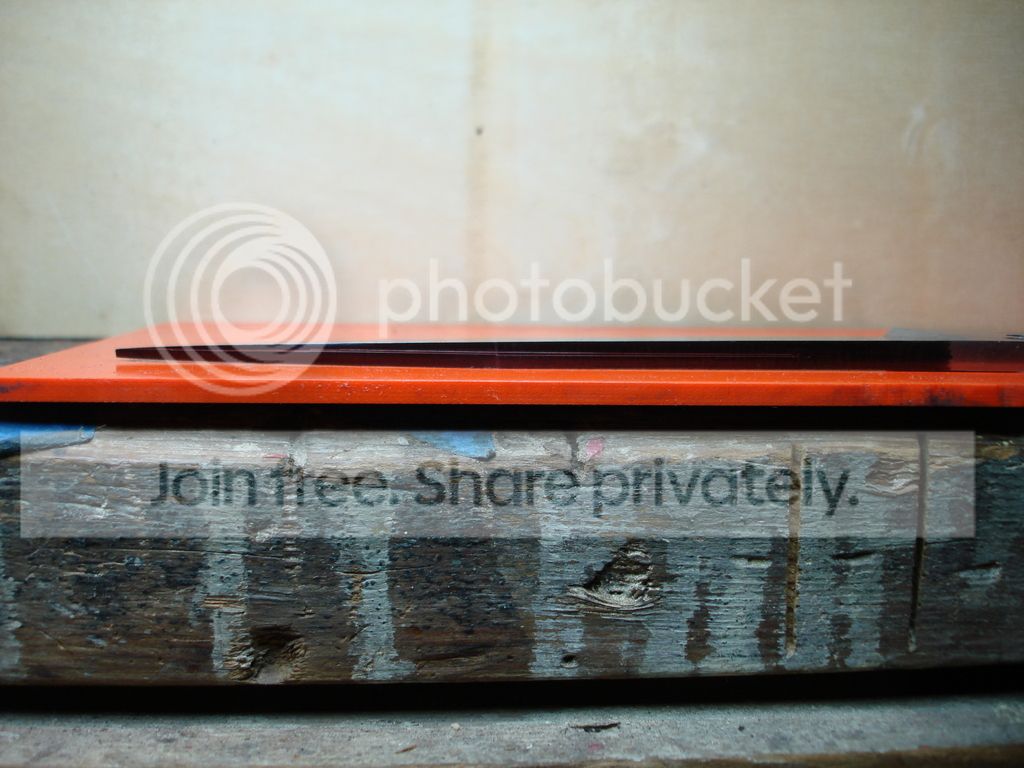

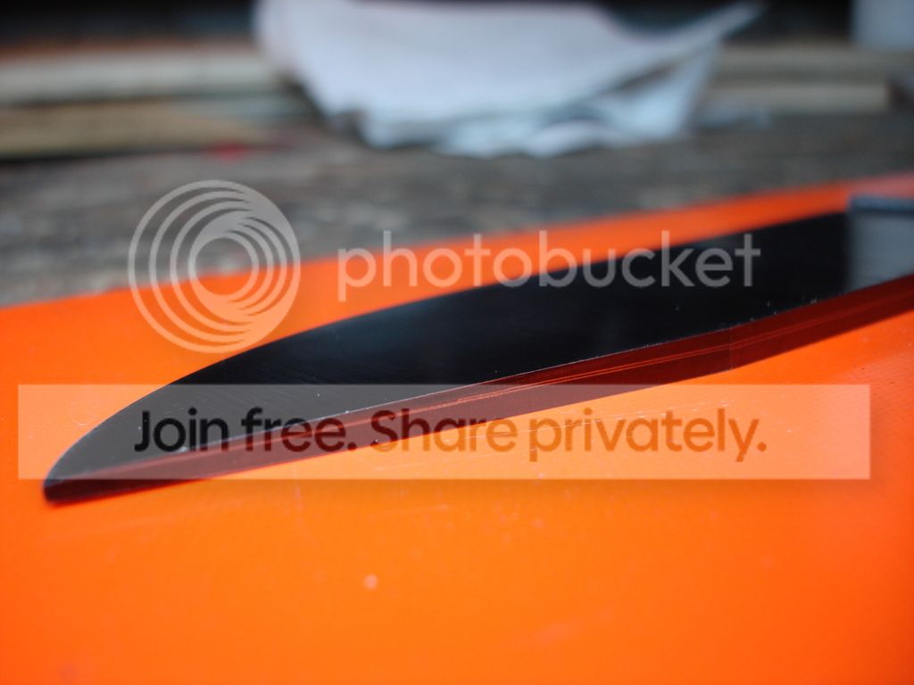

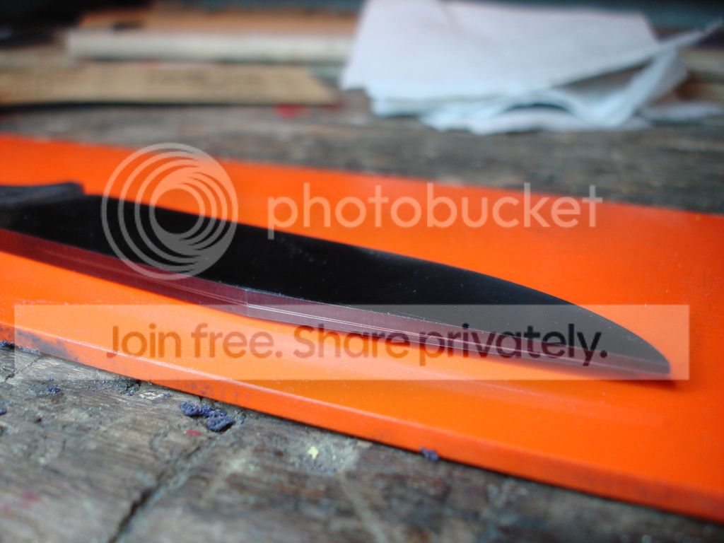

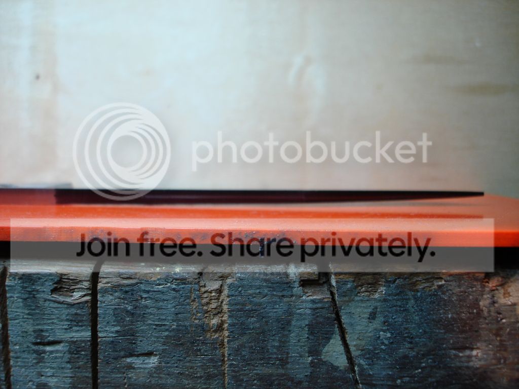

After I got it looking the best I could, I decided to try my hand at adding a swedge grind to the tip/spine. So I thought I'd go ahead and scribe a center line on the spine.... that's when I noticed this:
...As you can see, even though I was careful to keep the grind centered at the edge side of the blade, it is all way off center at the spine.
So much so that when I lay the blade flat, you can see that one side of the tip almost lays flat, while the other side is raised up quite a bit....
Also, as I mentioned, the "belly" portion of the edge is super thin compared to the rest of the edge. ??

By your picture, your knife is NOT way thick at the tip as you described in words, you blew past your scribe line, meaning you're way thin.
Remember that you cannot put material back on, when you are too thin in an area, grinding it more won't fix that.

As for this issue, what you did on that blade was essentially you ground in a "distal taper" on only one side of the blade. You did basically just as you described above. On the one side (the side where there is a larger gap between the tip and the flat table) while you were grinding, you were twisting the blade as you got closer to the tip, I use to do that all the time on accident, still do sometimes lol. It helps to scribe the center lines on the spine as well before you start grinding, so that you can keep track of the amount you are grinding off the spine side. Just try not to put extra pressure on the blade/spine when you reach that area as you are making you pass on the grinder.
