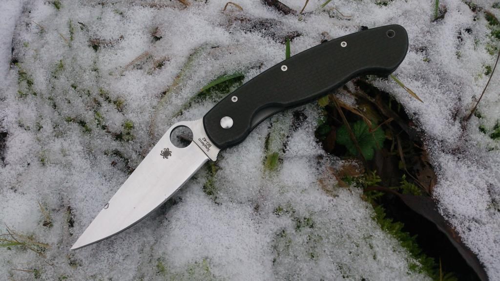

My well used one:

I have 3 of them. This reground one is my favorite knife. I don't always subscribe to the "butter zone steel" doctrine but it is at least a tangible thing in my observation.
Holy Smokes. That is a beautiful blade!
