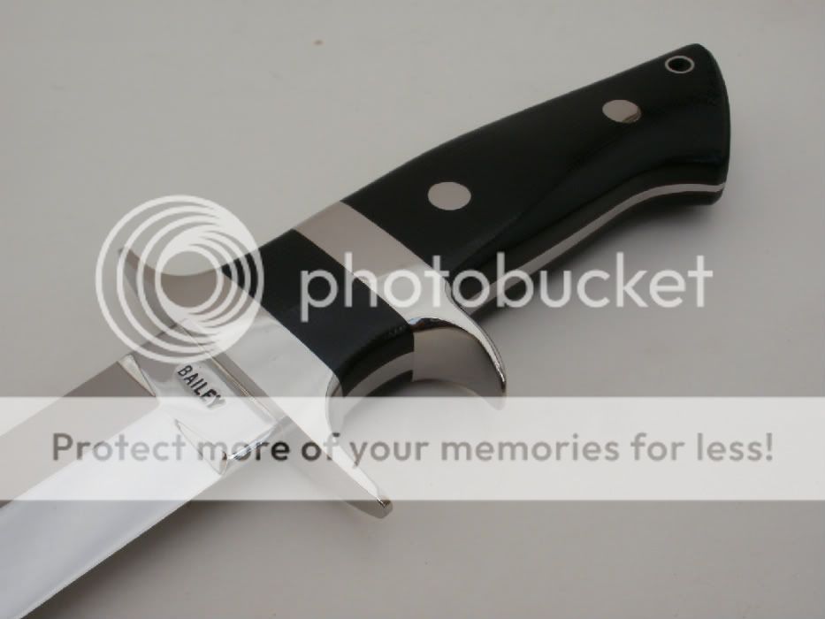

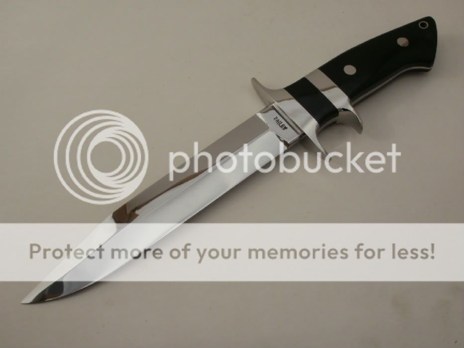

I've not been on here for a while....I've been busy in the workshop with a few projects, including this one.
It's not actually finished yet, as the handle needs a tweak here and there, the final polish hasn't been done, it's not sharpened yet and it has no sheath........other than that it's nearly there!
Blade is 8" 1095, flat ground, 13" overall. Handle is black canvas Micarta with dark red fibre liners. Fittings are 303 stainless...all typical me really!;):D
As always, thanks for taking time to look.:)
Ian
I think the blade is a bit too narrow for that size of handle, but it looks great otherwise. I'm loving the polish.

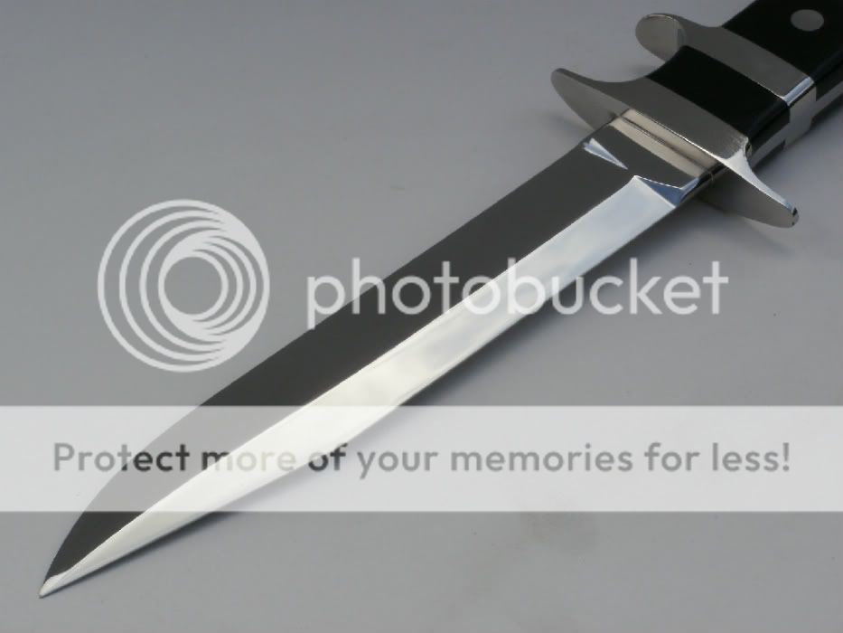

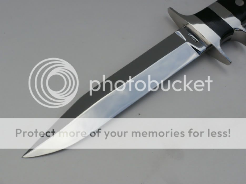

The blade does look a bit narrow in my poor photos...it is actually 1 1/4" wide. This photo shows it a bit better....shame about the reflections.:rolleyes:

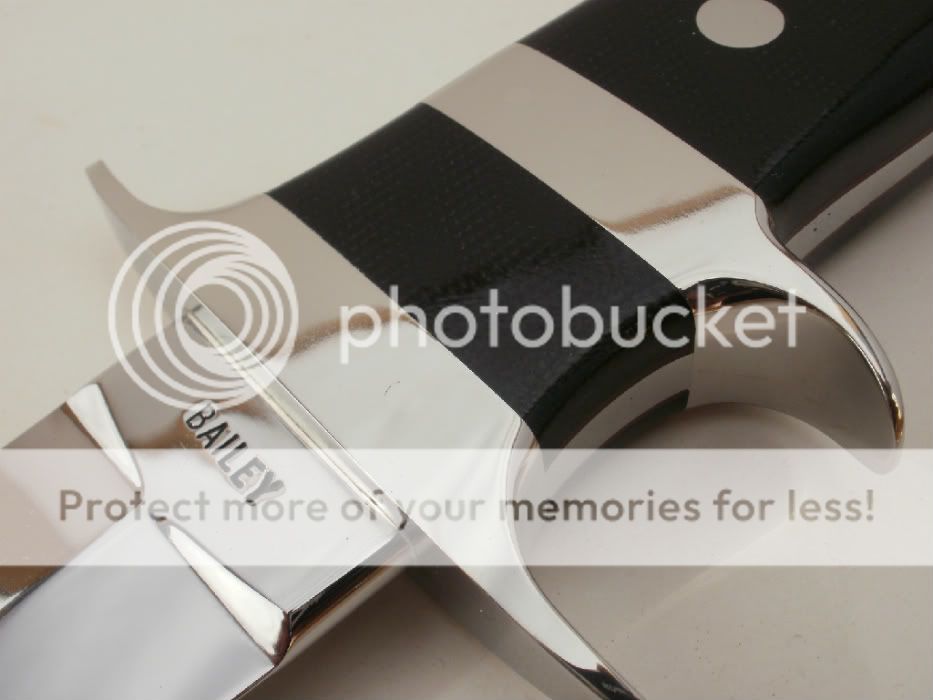

David, the guard is soldered....my milling skills aren't quite up to dry fitted guards yet.:D
