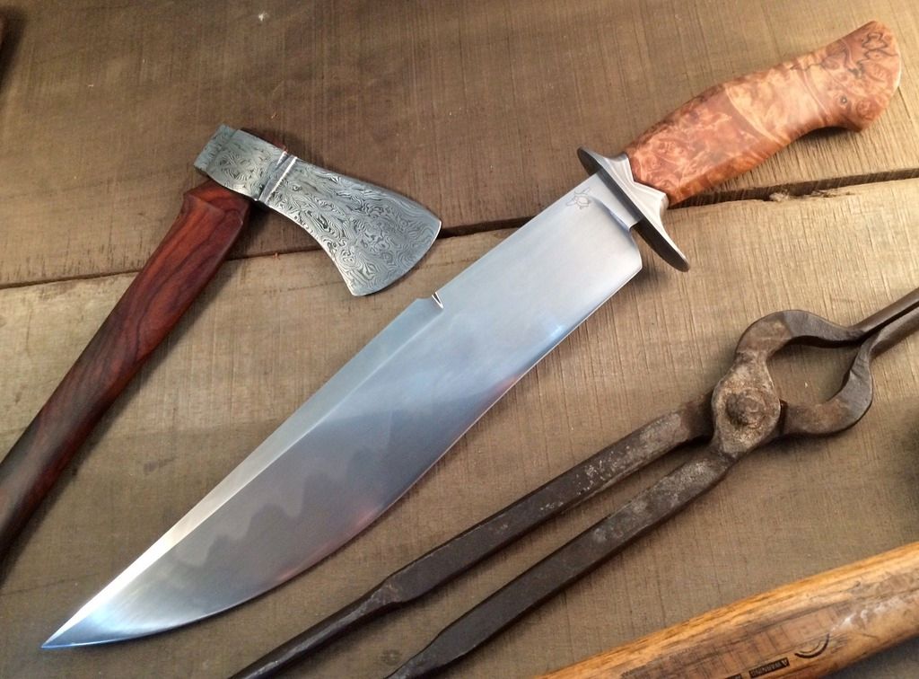

I've been working on this Bowie in between orders and projects and have finally got some time to finish it. Even though this was a fun, big blade to forge the guard/handle transition was the project for me. I'm trying to come up with a cool way to make the guard and handle fit together rather than flat on flat. The process is still a work in progress but it's been fun and so far I like the outcome. The tang is a hidden/through tang. The very end is peened over a damascus ferrule. The blade length is 12.5 inches and the OAL is 18.5 inches. Blade steel is 1095. The hamon is much nicer than my camera could capture so I will be sending this out for professional pics asap.

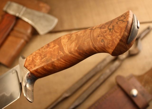

Here's a closer look at some of the details in the handle.

Makes a lot of sense, bedding the handle material into converging lines at the guard like that. Seems to me it would work something like a dovetail and provide additional support and retention. Looks cool as hell, to boot!
A really cool detail is how you can see from the distortion of the laminations that the guard was forged to that shape...
You are exactly right Lorien. The dovetailish thing is my goal while at the same time trying to create a look that is simple to reproduce while looking "new".
Thanks for noticing that! I was like a kid at Christmas as I pulled the damascus from the etchant. Seeing those laminations flowing just as I had intended was a big victory for me.

Awesome! Is the blade wider at the front? Is the swedge sharpened? And what is the thickness?
Yes, the blade is wider at the front though I don't have it handy for a measurement. The swage is not sharpened. The thickness near the guard is 5/16" and there is a constant taper starting at the swage. Thank you for looking!
