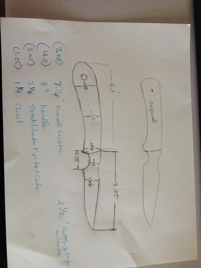

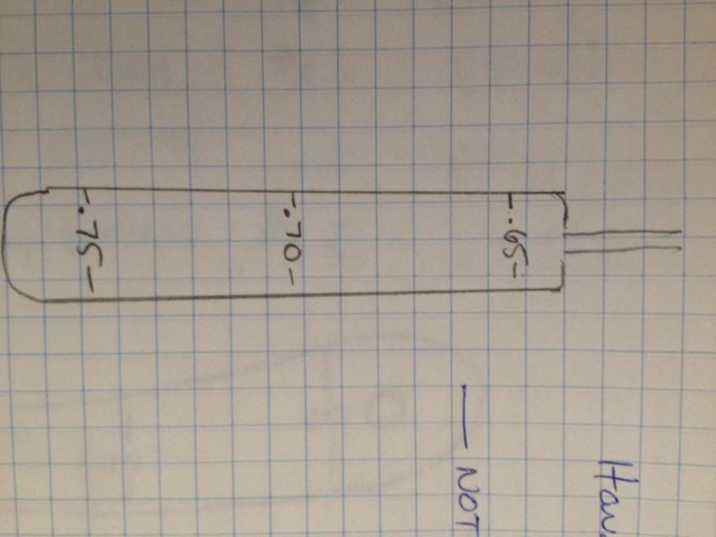

What I wanted in a Caper:

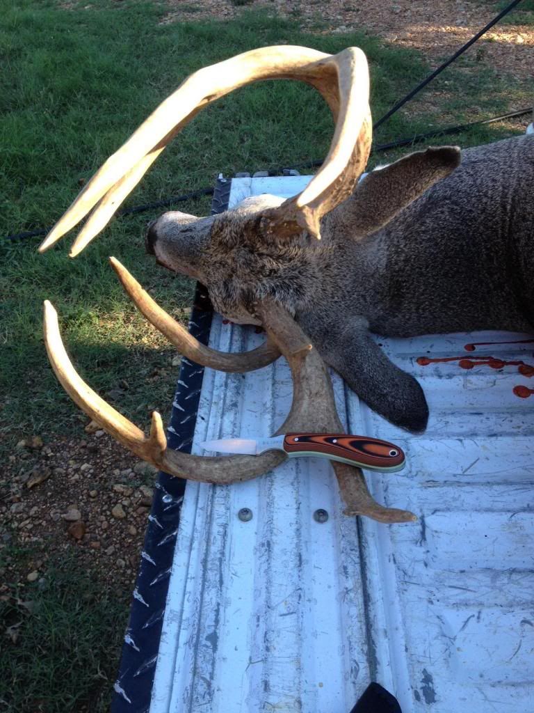

Since I had good luck with the KOA caper I wanted to have a custom built one that would fit my needs and hands better. I spoke to Chris a few times and I knew he understood what I wanted and I forwarded him some diagrams and measurements. He recommended S90V or CHP20X (I may have that name wrong). I had not heard of the 20X steel and after reading Ankerson's review and using Phil Wilson's Southfork in the kitchen; I felt S90V would meet my needs. I could sharpen it on the WorkSharp; it should last for 2 animals and was stainless. I traced the original KOA caper and made changes based on my needs, primarily a larger handle both in length and girth and a slightly longer blade to allow for larger choils as the originals are to small.
Chris recommended an increase in both the top and bottom choils. This was great as it fits my hand much better. He absolutely nailed the handle shape and size. I discovered over the years I need a large meaty handle for more control. I would normally have to take a minimum of two breaks while cleaning a deer due to my hands cramping up. Age, arthritis and diabetes blow. Chris exceeded by requirements as my hands did not cramp once and I had increased control over previous blades I have used. The execution of the quality workmanship is outstanding. All lines are clean with no sharp edges. The attention to the choils impressed me as they felt great and the best way to describe it as “worn in”.

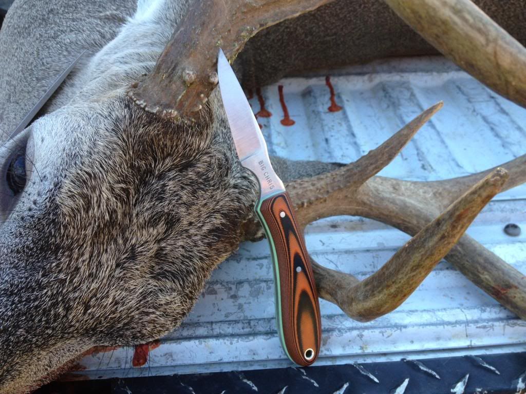

While removing the hide, tenderloins, back straps and cleaning out the pelvis this blade worked better than any other I have ever used. I received the blade as hair shaving sharp and it stayed that way after this animal. I believe the RC is 60-61 and Chris did the heat treat. I am very rough on an edge and have no concerns about running up against bone to obtain the best cut possible. Now I will see if it makes it through a few more animals before needing a sharpening. After this deer there we no visible nicks or damage to the edge and it would still shave hair. I am waiting to shoot something big enough to cape out, however, I have caped enough deer with the KOA to know this one will work exceptionally well. The skinny tip and choils allow you to work around the delicate areas of the eyes and lips.
**reserved for pic **
Sheath….
I normally would not say much about a sheath as long as it keeps the blade from cutting me. I have to say I am impressed with the sheath as it is the best sheath I currently own and on par with those from full time sheath makers I have owned from this forum.
The blade is the perfect length for everything on a deer save two items, removing back strap (running along the spine) and cutting through a heavily muscled neck to remove the head. The blade will do it, but it is limited by the length and you have to get bloodier. These are the two items I reserve for the larger blade and you can see I am trying out the Rodent Trail for that one.
Overall, I cannot say enough good things about Chris and his attention to details. I believe I will have him make two more identical to this one to give as graduation gifts.
By the way the buck was 5 1/2 yrs old, scored 128 5/8 gross, 175lbs and only the third time we had seen him all year. The first in person, the other two on game camera.
Thanks for posting this in depth review. It's nice to see some real world use of a well designed and crafted blade. I think Chris did a great job on this blade, and the steel choice is good for this type of use IMO.
great review, and many props to Big Chris for Doing It Right. Please post an update later in the season to let us know how it holds up!
Thanks for a great review with excellent pics. I'd love to see a pic of the sheath & how this handle-heavy blade fits in it.
So I let me nephew use it last night to clean this deer. It still shaves hair. More to follow.
Update on the blade. Cleaned a hog with it a few weeks ago. So far all I have done to it is was it with soap and water. Still hair shaving sharp. More to follow as my next hunt is in late October. No deer this year as we are off our old place.
