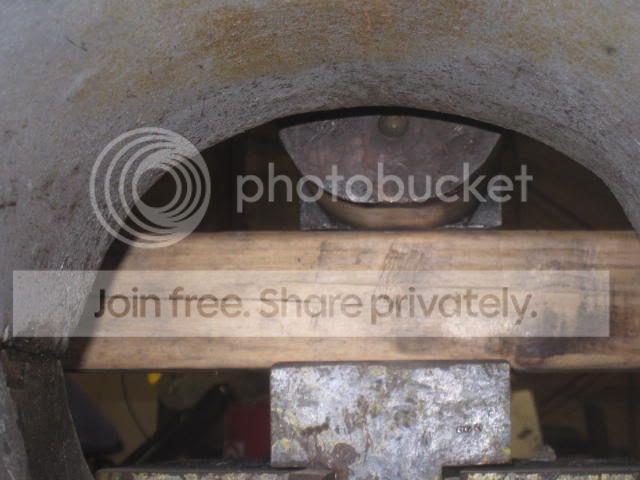

I removed the plate that someone had welded on top of the lower die:
Also put the upper die back on the ram and the ram back on the hammer:

Got the hammer mounted on 2 layers of 2X lumber. Right now it's free floating, but I'll be screwing it to the floor to keep it from walking away.
