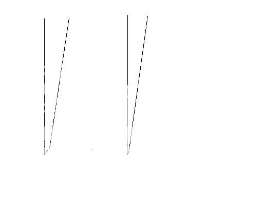

only aussing the primary grind and reliefe bevel are the same.
if you have a 30mm deep blade (like a big spyderco) and you grind it so that you have a edge bevel of 3mm or so at 30degrees total the the blade is 0.52mm thick. if you ground it so that the primary grind was more acute and have the blade half this thickess 3mm behind the cutting edge but still had a 15degree bevel then you'd be removing much less metal
If I misunderstood you Andy, I apologize.
You are correct, but I did not assume you were talking about microbevels from your original post.
However, what I say is still true. Even if it is not in conflict with what you are saying (and it isn't, because I do agree with you- and frankly there is no room to disagree since you are correct).
If you have two knives at 30 degrees, one in S30V and one in ZDP-189, and you decide to reprofile the ZDP-189 knife to 20 degrees because it can handle it, then you are increasing the surface area of the final bevel (that you sharpen).
This does not account for microbevels, but I saw no mention of them in your original post.
I did not mean for my reply to slander you or say your belief is wrong. But I feel that what you said was incorrect, even if only for missing key concepts such as a microbevel. Perhaps it was to be assumed. Someone else assumed it. But I didn't. I think that most people do not use them or take them for granted in a discussion.
I do apologize. I have being "corrected" when I was not wrong in the first place, or nitpicked when the pickednits were implied and it is assumed the readers would know the particulars. But I misunderstood you and didn't take microbevels as a given.

Hair my first post was badly worded, it's something I try to sort out but in written words I'm rather bad at explaining things. I'm happy for people to say that they don't follow or ask me to explain it better, it's the only way I'll improve yes if you have a knife and regrind it to 20degrees inclusive rather then 30 then you will increase the amount of metal you have to remove. Hopefully the maker will use the benifits of the steel so that you don't have to do this though. It doesn't mean they will though. Of course you'll get better performace if you put a back bevel on which is much more acute then the final cutting bevel and you only need to have the course stones to do that which work faster, you can then add a micro bevel with a finer stone and any touch ups wont involve removing much metal
