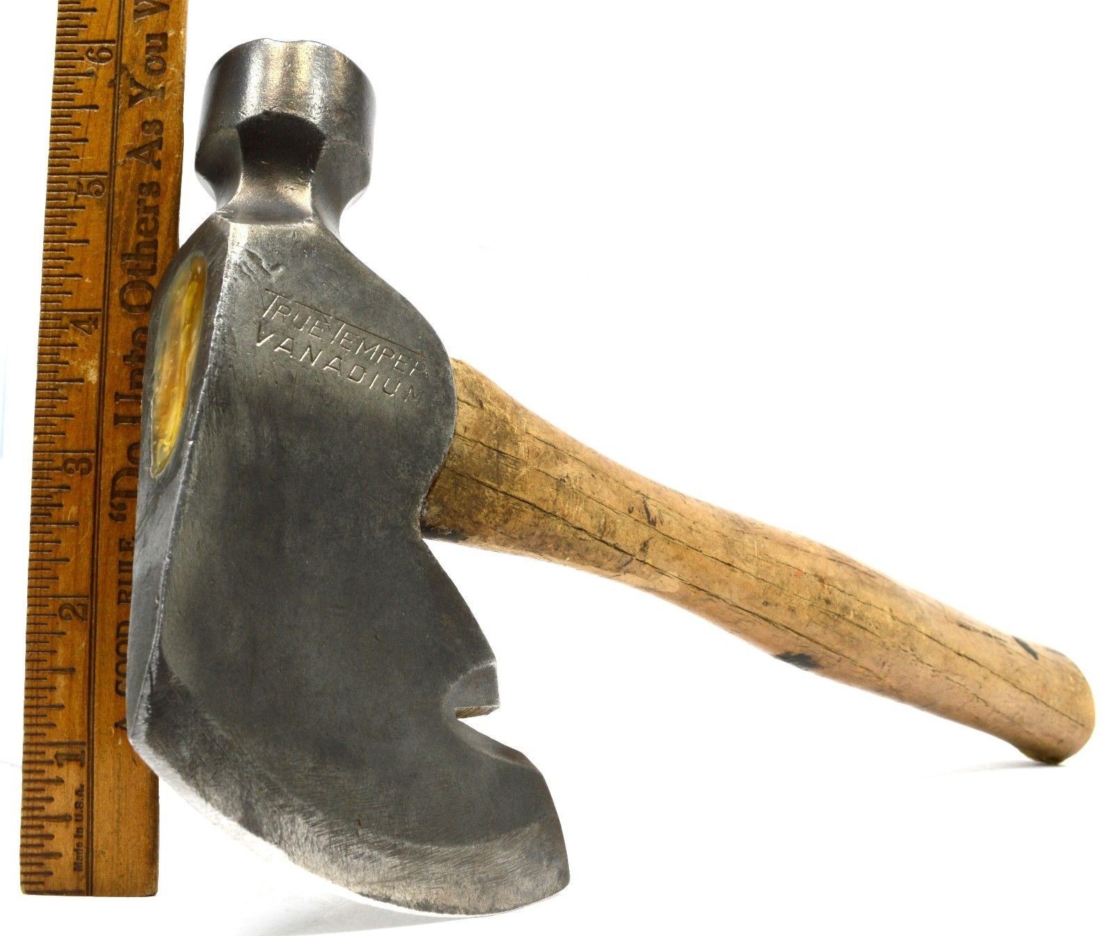

I can attest to the quality of the TT Kelly Perfect half hatchets. I have my uncle's old Perfect hatchet that was used to bark staves, and sharpen umpteen thousands of tobacco sticks throughout the 70's and 80's. I bought this like new one a few years ago because of the known quality. A hundred dollar bill won't buy it.
With the clear unpainted finish on that Perfect hatchet it might be a vanadium steel head. Adds a little rust resistance but it isn't necessarily better steel than the Dynamic in terms of edge holding or toughness.
Looks like maybe nickel plated?
