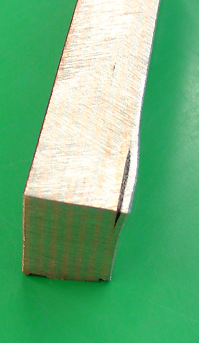

welll i know i at least got it close
other then going at it too hard withe the mill and going the wrong way at that
its together
might have just got lucky

As for the first attempt...looks pretty good. You may be able to get that one layer to stick down with a hammer and a forge, or you mill off the top layer. Whole lot more useful than my puddle at any rate :D
Did you coat the plates with anything? Could that delamination be due to some sticking as it was removed from the plates?
-d
pickle and clean out the split area.tap the split closed,flux and hard solder it back together. now you just need to get the pattern into the billet without more delamination.:)
ooo the delam is from running the mill wrong
i think im going to clean it up and rerun it in the kiln at like 1825 or so i want to make sure about it being fused
i plan on doing a twist pat. to it
also it must have been about right cause the SS foil started to fuse to the stack
that little bit that is sticking out i will most likly cut off after the twisting
