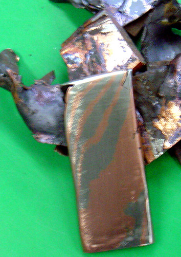

i am stil thinking about taking it up a little higher in temp is there any good way to tell just how well my stack fused
i dont want to melt it down
solder the split.hammer the bar round ,anneal it and twist the bar. trying to refuse it will be a waste of time and effort. you will know real fast if your billet fused right with a little twist action applied to it.
wish me luck im getting ready to do some twisting on it :thumbdn: :thumbup:
we will see how it goes and about an hour or so
bunk :thumbdn: it only sorta worked next time around im going to try fuse temp at 1870
but at least i see how to do it now and forging it man you need some heat to do that i was using my kiln to get it up to heat :foot:
i need to set up a forge soon
i ll post pictures of the mess soon i hope
butch
you were forging it hot? i guess some people do, but i never found a need to forge any non ferrous mokume above room temperature.
yep i was forging it hot it was moving well next time i ll try some cold working
i do believe that i just never got the billet to fuse all the way in the first place
also twisting was harder then i thought it was going to be even at 1800 but then agaiin the stack was about 3/4x3/4 x5 inches i ll just look at it as learning and i ll do it better next time
butch
make your next billet 3/8ths inch X 3/8ths inch X 5 inches long. i think you bit off more than you could handle before learning the basics. if you can't fuse a 3/8ths inch billet and have it hold together while twisting it cold, you will need to rethink your plans. it should work and twist like soft butter.

i might be able to save some of this after all but not for the gaurds and fittings i had planed
looks like i might drill a few holes in it and pound it thiner maybe i can use it for bolsters on a folder its a 1/4 inch thick and alittle over an inch and a 1/4 wide
