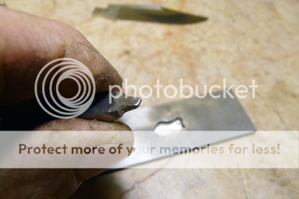

Here's my old Case Sodbuster which I bought new in 1973. As you can see I used it hard and finally the spring broke. Instead of sending it in for repair, I used it as a pattern. The pivot has brass washers and a 1/8" pivot pin. Someday I'll make it a new spring.
