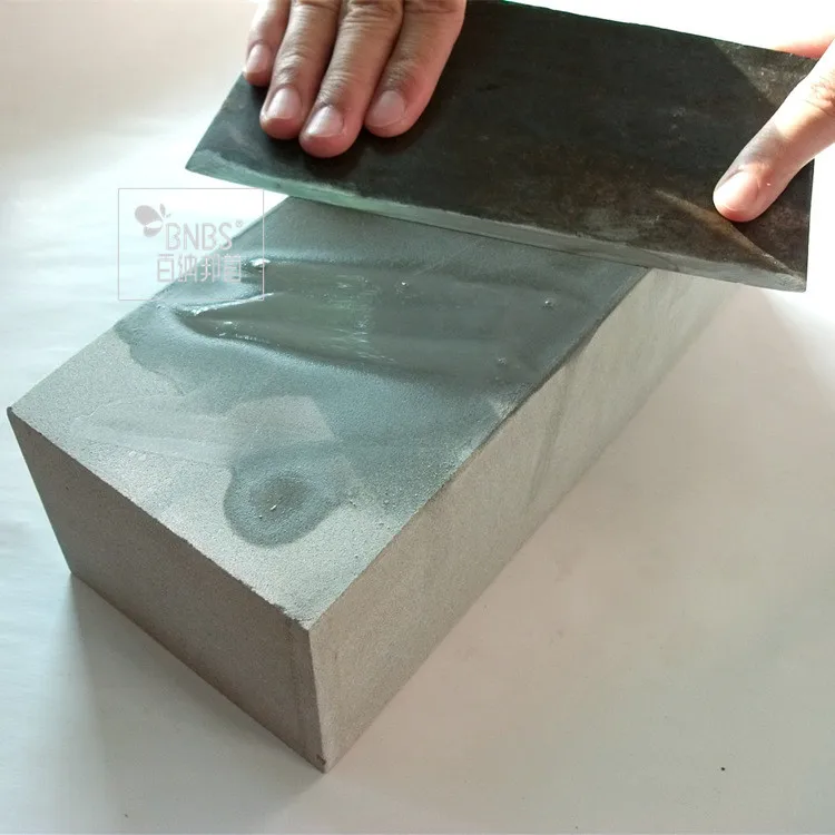

Maybe an extra wide stone would be better?
Who makes that behemoth?
It's a cheap chinese stone..800 grit. If youre still interested, search: BNBS natural whetstone 800#

Appreciate it. I'll pass word along.
