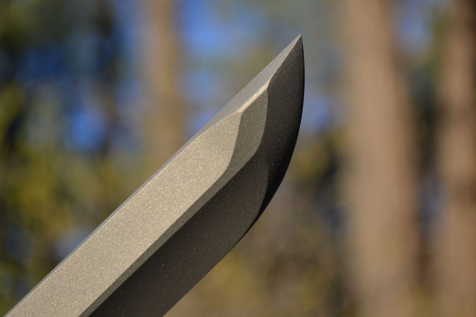

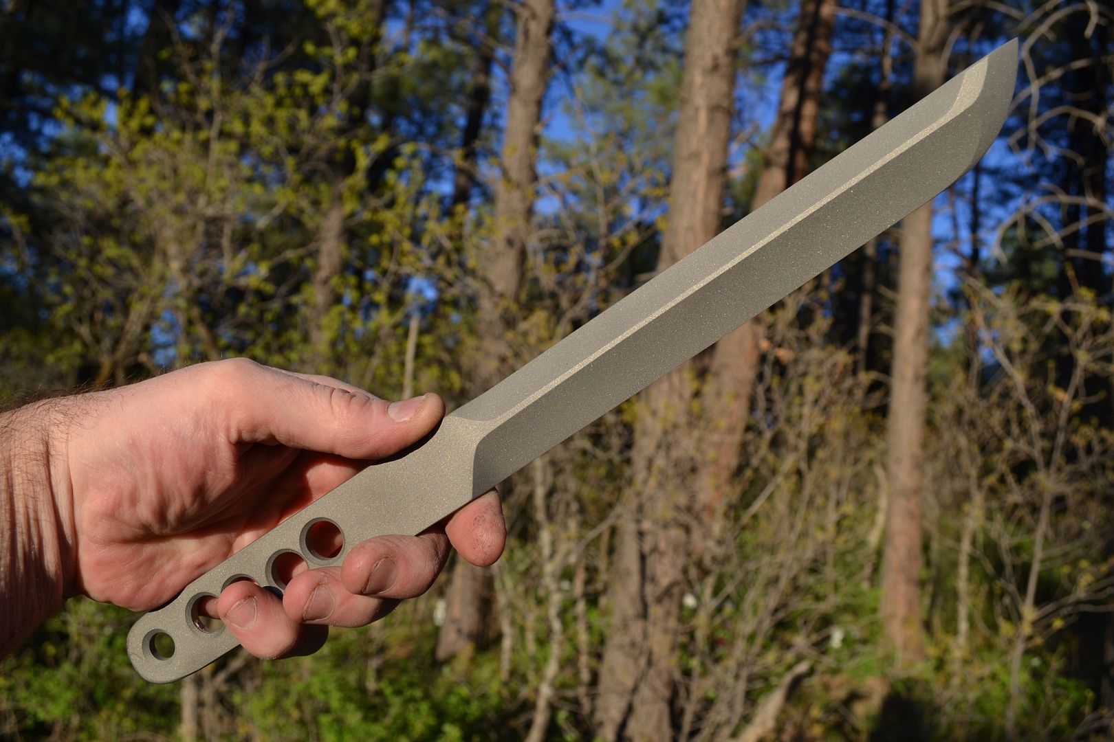

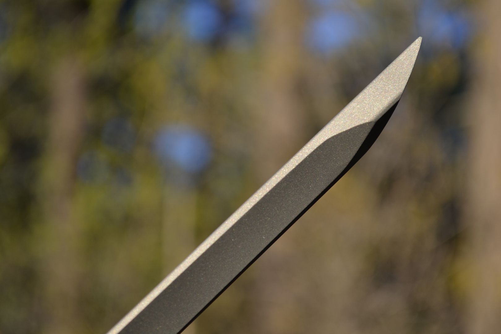

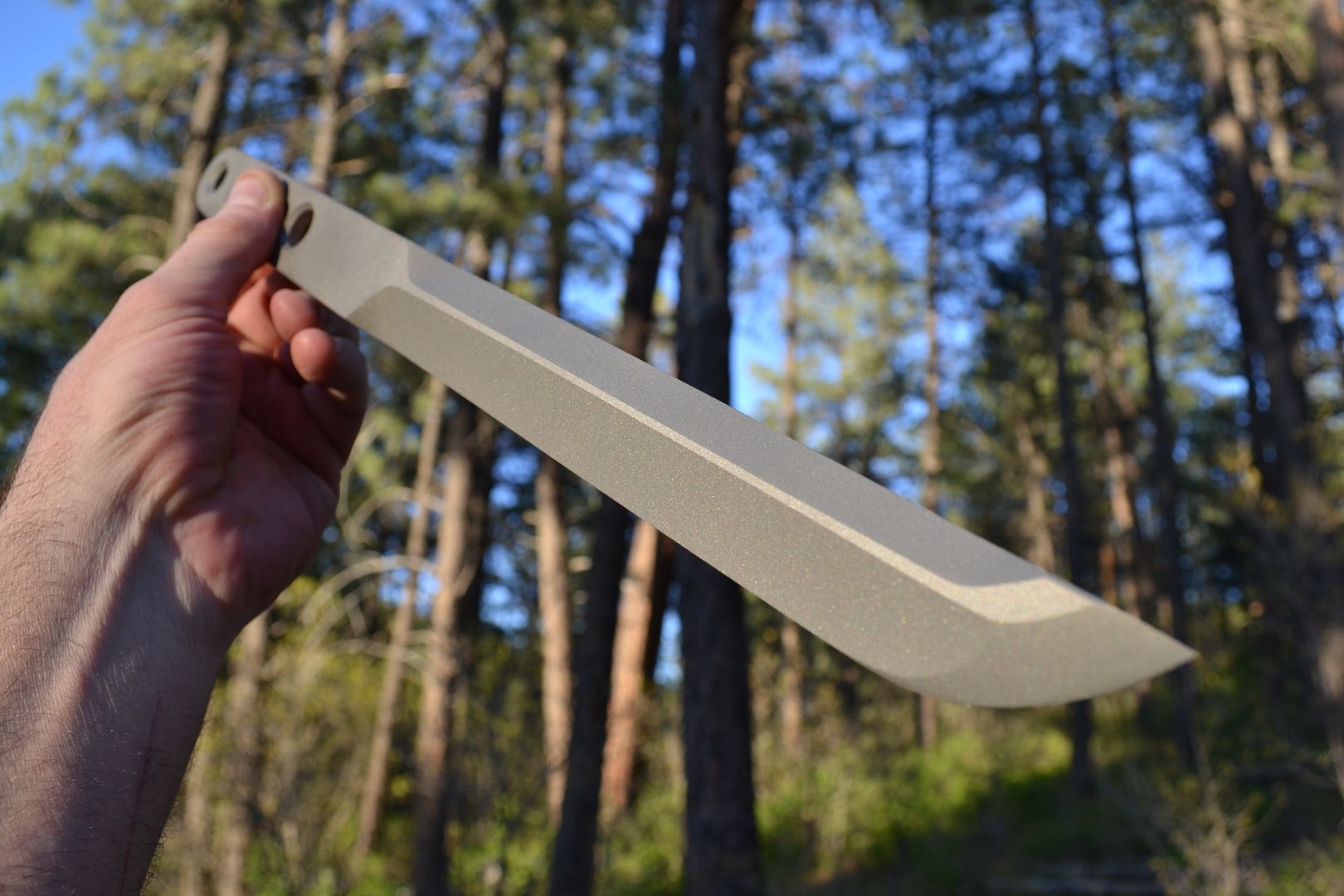

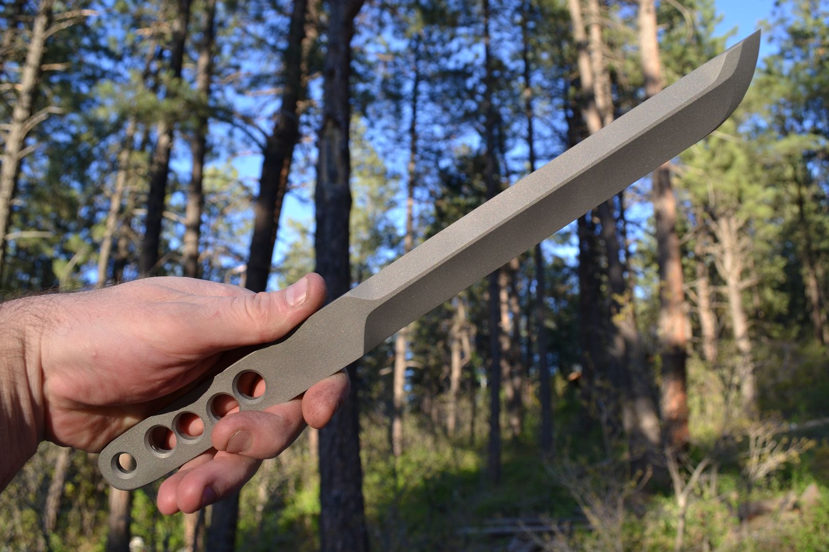

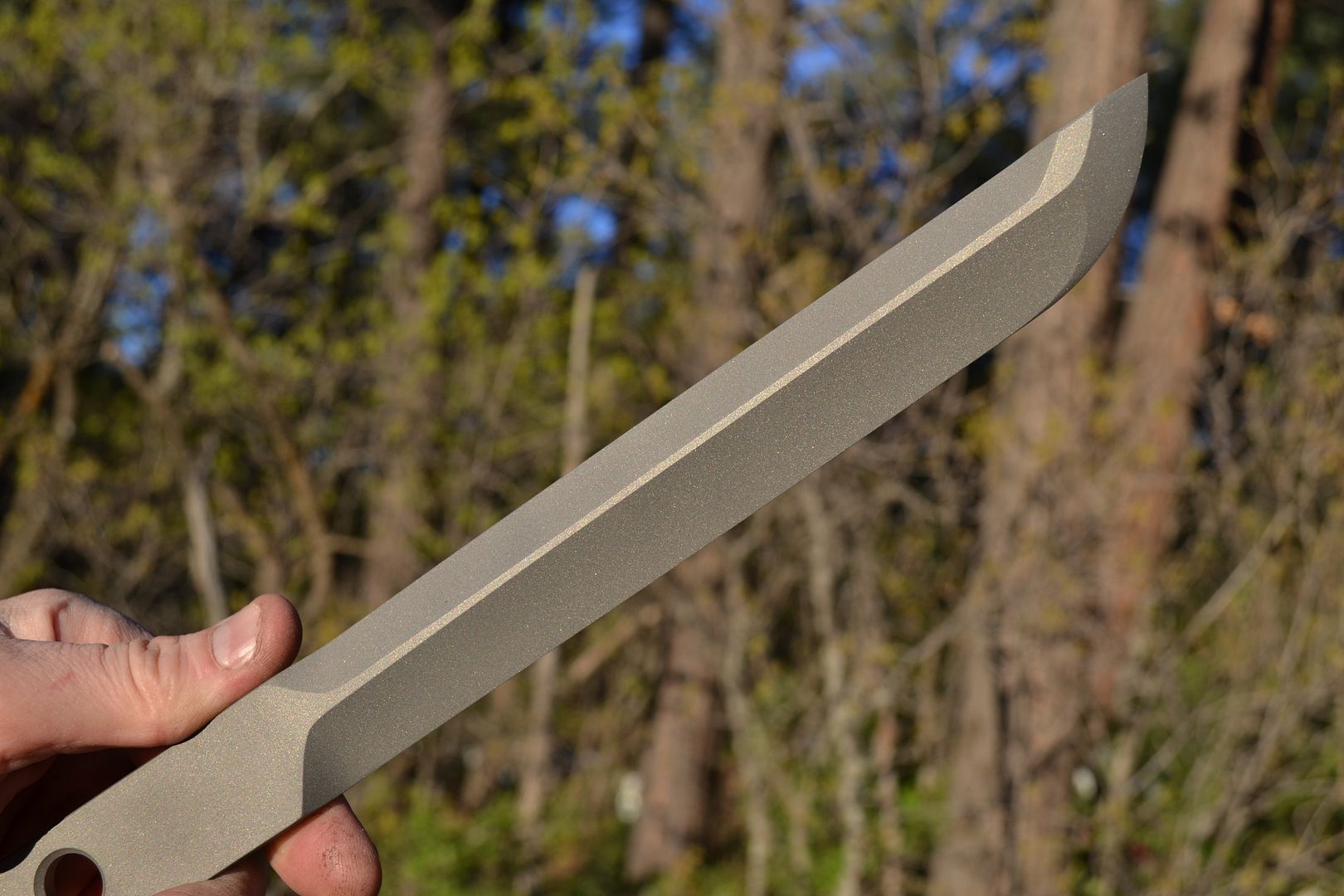

.25" thick and 12 or 13" long! I think 13" but just walked in from grinding it a while ago! :D
The grind is based on a traditional katana grind. It's crazy fast in the hand! Enjoy!

Daaaaaaaaaaaaaaaaaaang!!!!! Daniel,that grind is sooooooooo ILL!!!! How did you get that finish? It is so clean!
Thanks! That grind took me many knives to get right so that means a lot to hear! These long ones get tricky. That's the bling blast, I use garnet media. I had it at 400 grit first and it was cool that way too, just shows scratches easier. I'm debating on the final finish. I may stonewash as it is a cool look... brings back the 400 grit finish in some ways for neat effect. Maybe heat color!

Personally, I'm not crazy about the tip profile on the spine side, have you ever tried taking the spine grind all the way off the tip? Your tanto geometry for the tip will retain the extra mass and strength your after, but I think the extended grind will help balance. Super clean grinds though! Well executed :thumbup:
