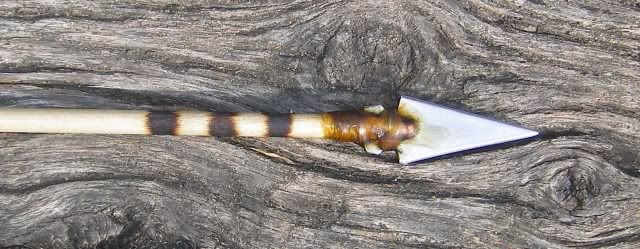

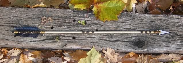

yes but those arrows are free. I do most of my tillering with a friend who runs a youth archery range so thats where the arrows come from. The other problem I have is that I never have more than six of my own arrows at a time because they are good to trade for flint/chert, antler, and other supplies and I only make three or four at a time. I have another thread about a new style of "trade point" arrow I have made.
http://www.bladeforums.com/forums/showthread.php?p=8922536#
The first one is in the pic and now I have two more for a total of three. I will give these three as a gift tomorrow and once again I will only have two river cane arrows for myself. This one is birch:

I would love to have a hundred shafts at my disposal, that would be such a time saver. Unless someone gives me shafts to make arrows for them all of my arrows are rivercane. It is very abundant but not as easy to find the perfect stalks for arrows. I don't care if they are straight(fire can fix that easily enough) but the taper has to be just right and I prefer to find the right shaft lengths with six nodes. I might be too picky but I think that having very similar characteristics helps the cane arrows fly the same even thought there is a fairly big difference between each shaft.
I have even thought about buying shafts of cedar like most trad shooters make arrows from but have decided against it because thats not what I want to hunt with. It means a whole lot more to me to take even a rabbit with an arrow that I made start to finish that it does to have more arrows or an easier time making them. I usually try to take good cane shafts home when I find them but I might only get two or three that fit my preferences each time I go out.
