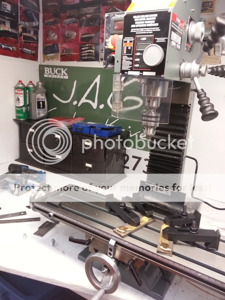

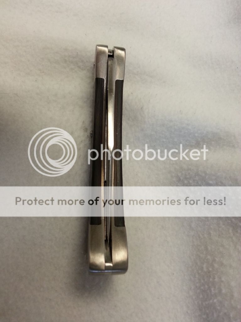

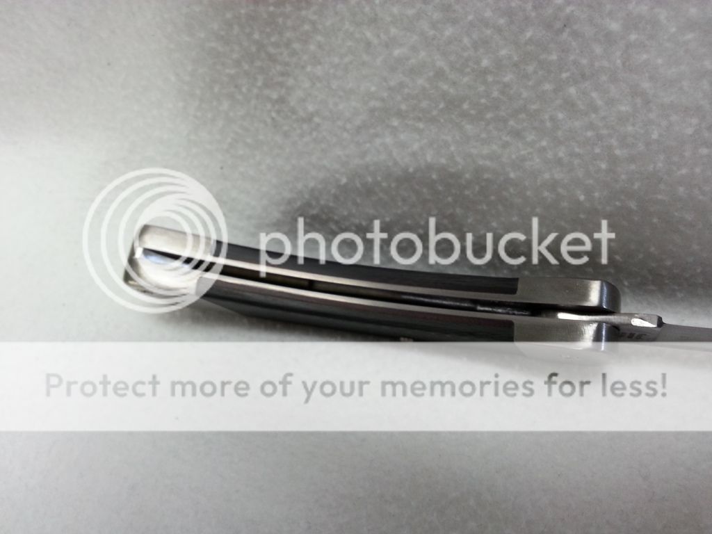

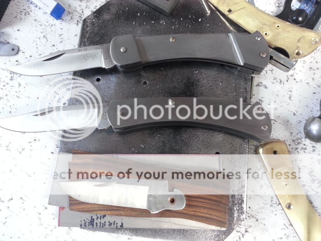

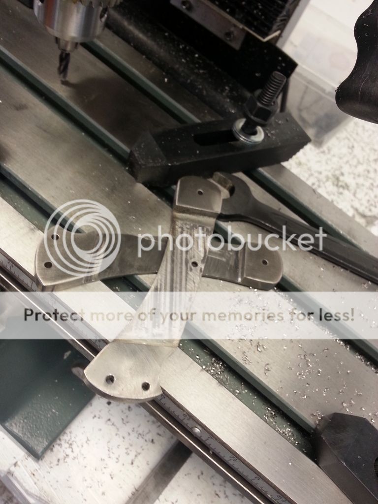

These bolster halves started as a .285" billet of 6AL-4V Titanium. They are hand milled, not CNC. I am contemplating using 5-40 threads with Helicoil inserts for extra strength, but possibly Stainless Barrel nuts (That I commonly use)
Here's a few Titanium Buck Knives I have on the go:

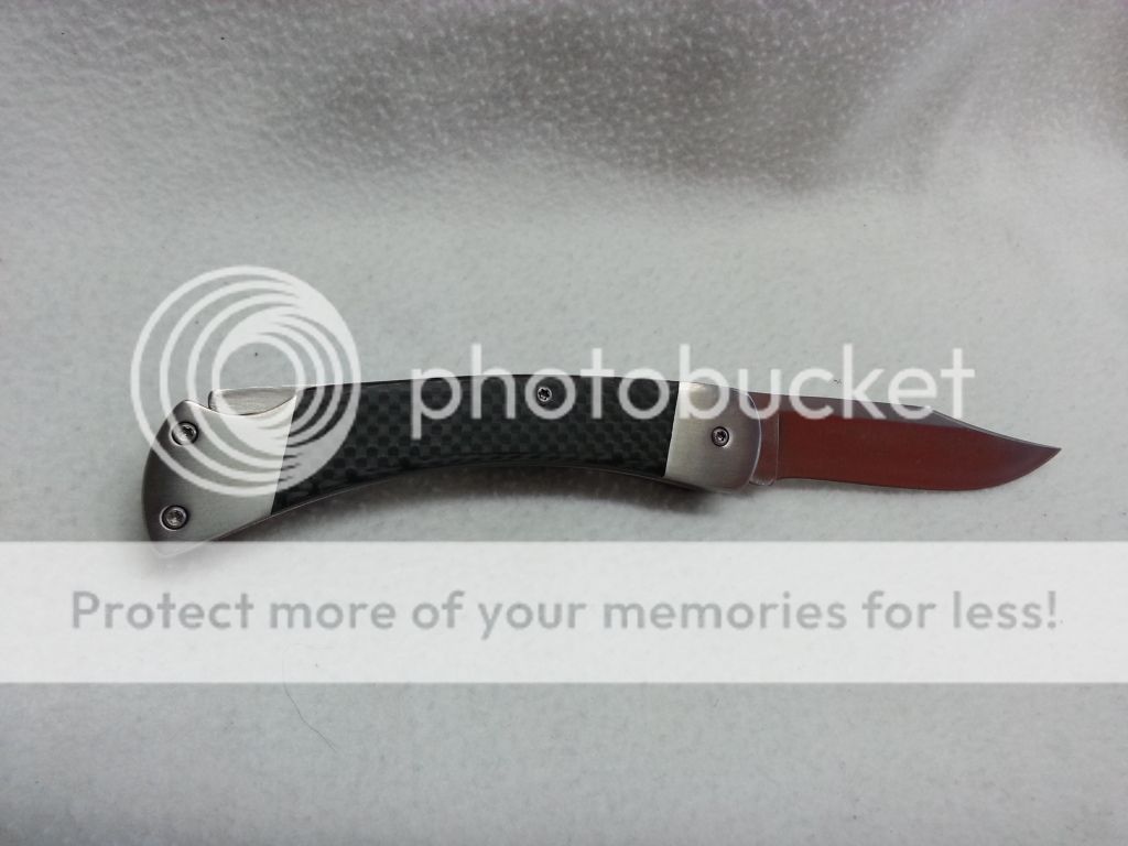

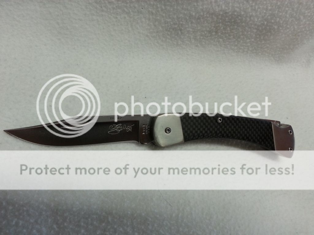

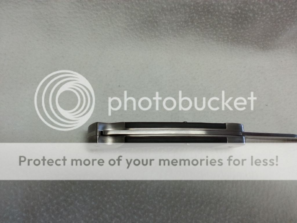

Here is the finished product: Those are Titanium screws holding it together. I used a buffing technique to bring out some grain in the Carbon Fiber you can feel as I find it a little slippery when wet.
Holy crap!!!!!,whoever said dreams never come true didn't know what they were talking about lol.I love it!
Hi Jared, You can save a little time and effort by drilling and tapping the right hand scale with four #5X40 female threads and drilling clearance holes (.125") in the left hand scale. No Helicoil should be necessary in holes that deep. If you use socket head bolts, a #5X40 counterbore will help get the heads flush with the handle.
