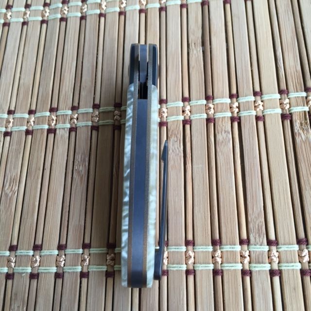

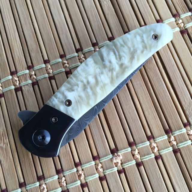

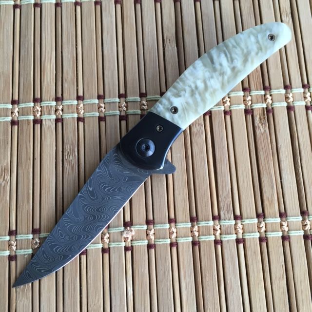

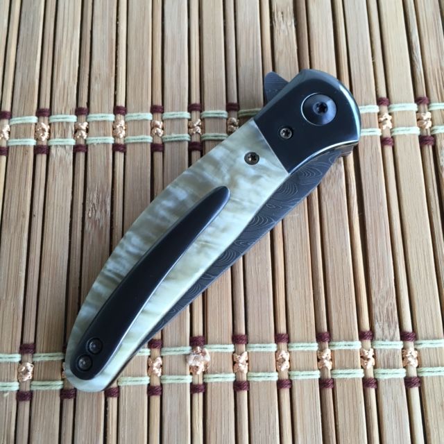

I've been really busy after Blade this summer. This is something I've been thinking on since last winter. Just got around to finally doing something about it. For those that are questioning! yes I will still be making my own Damascus.:thumbup: I was at Chad Nichols booth @ Blade and picked up a bar of his Damascus. I think they call this boomerang? The Zirc bolsters / back spacer / Clip are all sanded to 2000 polished and heat colored. The Ti liners are jeweled on the inside and gold anodized. The musk ox is proud fit to the bolsters.
As always comments / critiques are always welcome.

Looks great, nice color to the screws!

Great execution of a really nice design, and I love how you combined those materials. That's some of the cleanest musk ox horn I've seen--is it stabilized?

Will, I had it stabilized about a year ago. I ask several makers that use it regular and most suggested to have it done.

Great looking knife, I really like the 'swirl' of the ox. How does it hold up / age?
Musk ox is has been stabilized. I know of several knife maker's that use it a lot in kitchen knives. Thanks for asking.
