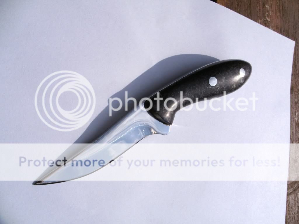

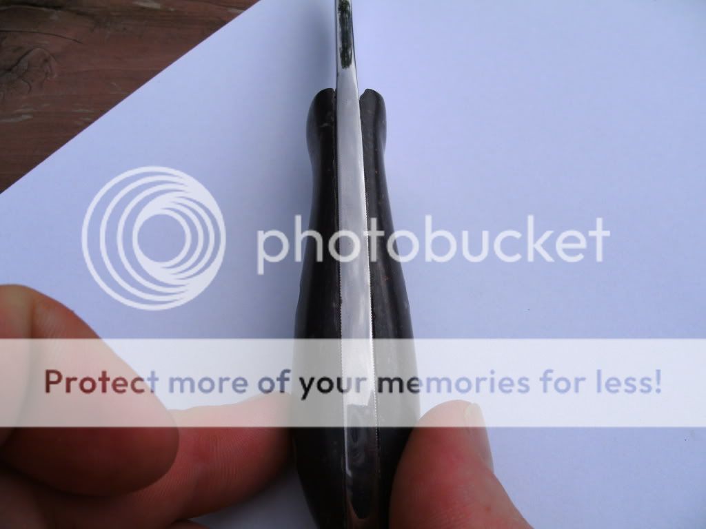

After seeing this thread about a bird and trout knife Mr Lamont Coombs made, I thought I should try making one of those myself. I modified the design a bit to fit my skills and learning process as I am just a beginner at knifemaking (this is my 5th knife). I am very pleased with the result and I would very much like to hear what you think of it!

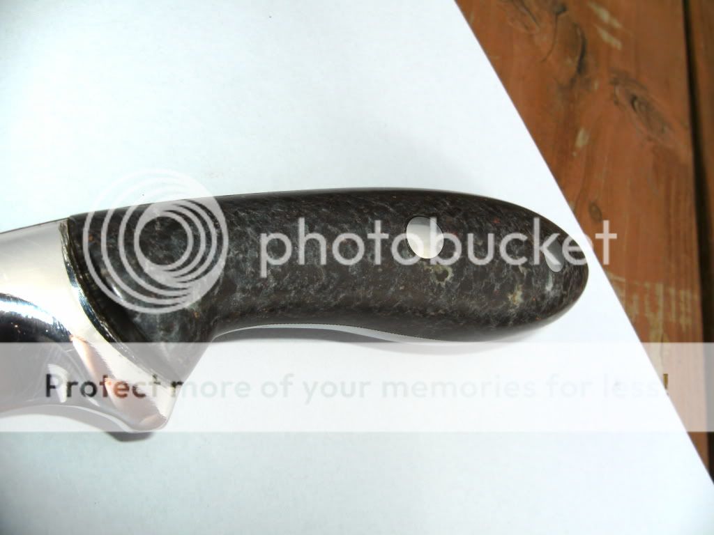

Oh, the handlematerial is zimbabwean serpentine (a medium-hard kind of "soapstone") which is not too hard to shape and yet weather resistent.
The knife itself is made from a file using an anglegrinder and polished to a mirror finish

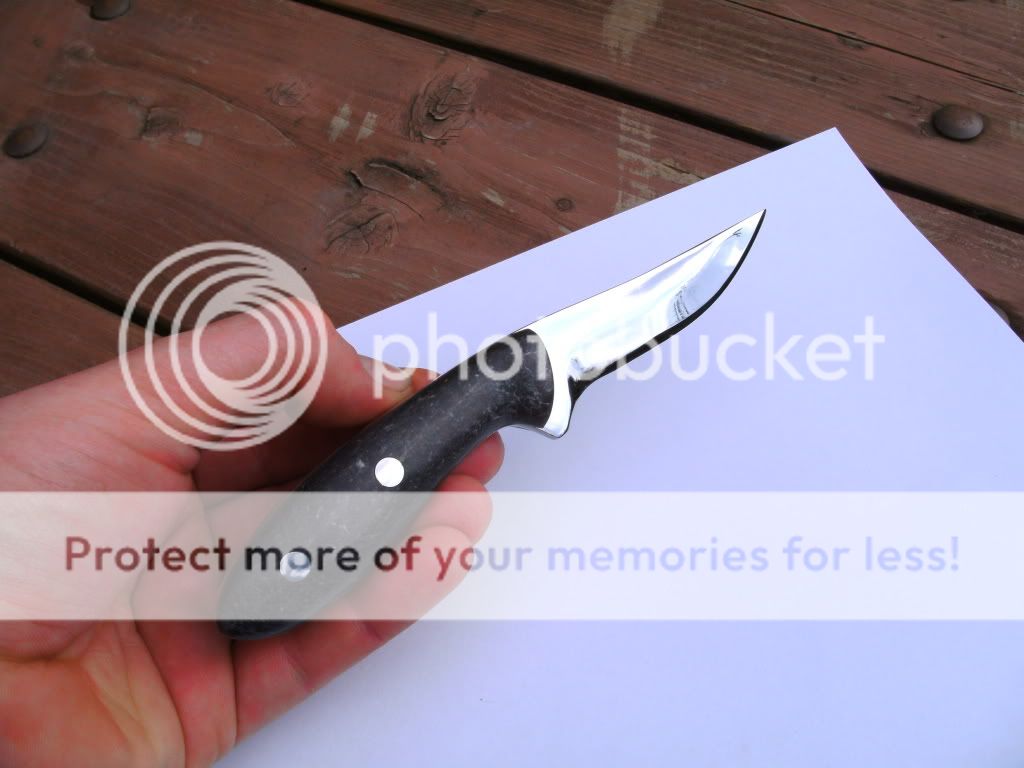

Pretty cool. The shape has a very nice flow to it, and it looks like it would feel good in hand.
Peter

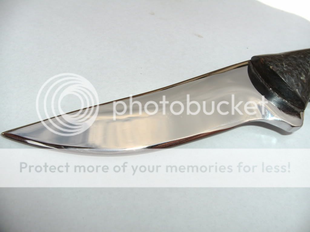

Very nice work for a fifth effort. I would suggest working at keeping the same level of polish while maintaining the sharp edges of your grinds. This really helps the work to "pop".

I'm having some trouble with keeping sharp grindlines as black mamba mentioned, not because of the polish but just maintaining the lines while grinding with the anglegrinder. Do you guys have some tips on this? I'm thinking of getting a belt grinder, does this make it easier to maintain sharp grindlines? Or are there other tools,tips or tricks to keep the edges sharper? other than patience and practice;) (is there a thread about this on the forum?)

The knife looks good, especially for it being only your 5th. That stone handle definately looks interesting, I like the look of it.
An angle grinder is definately not the right tool for this sort of task and will be very difficult to get consistant grinding with, as well as the additional risk of overheating, etc.
Definately invest in a good belt grinder when you can, it will allow you to greatly improve your grinds (with a bit of practice of course ;) ). 2" x 72" belt grinders are sort of the "industry standard" among most knifemakers. The 2" wide belt gives you more control with your beveling to help keep things even, over a 1" wide belt, and the 72" length means your belt life is a bit longer. Additionally 2" x 72" belts are some of the more common and have a very wide range of grits/types available, more so than some of the other sizes.

You have a good eye for design - the shape is very graceful.
I like bird and trout knives even though I don't hunt or fish, because they're so darn useful for just about anything.
