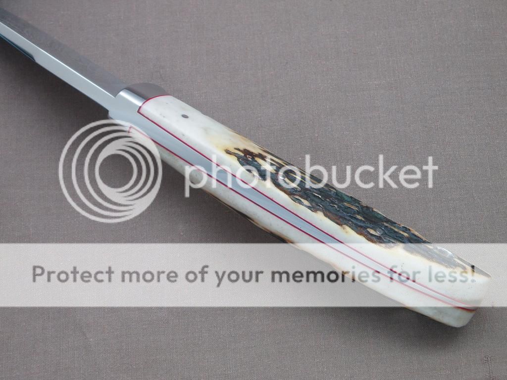

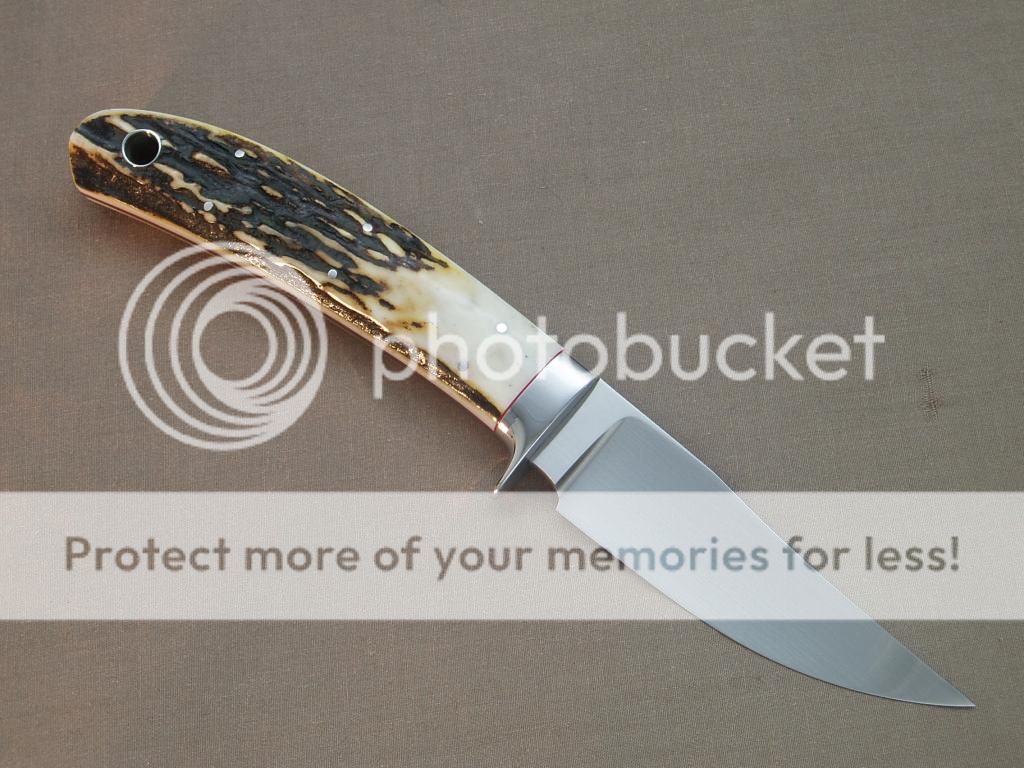

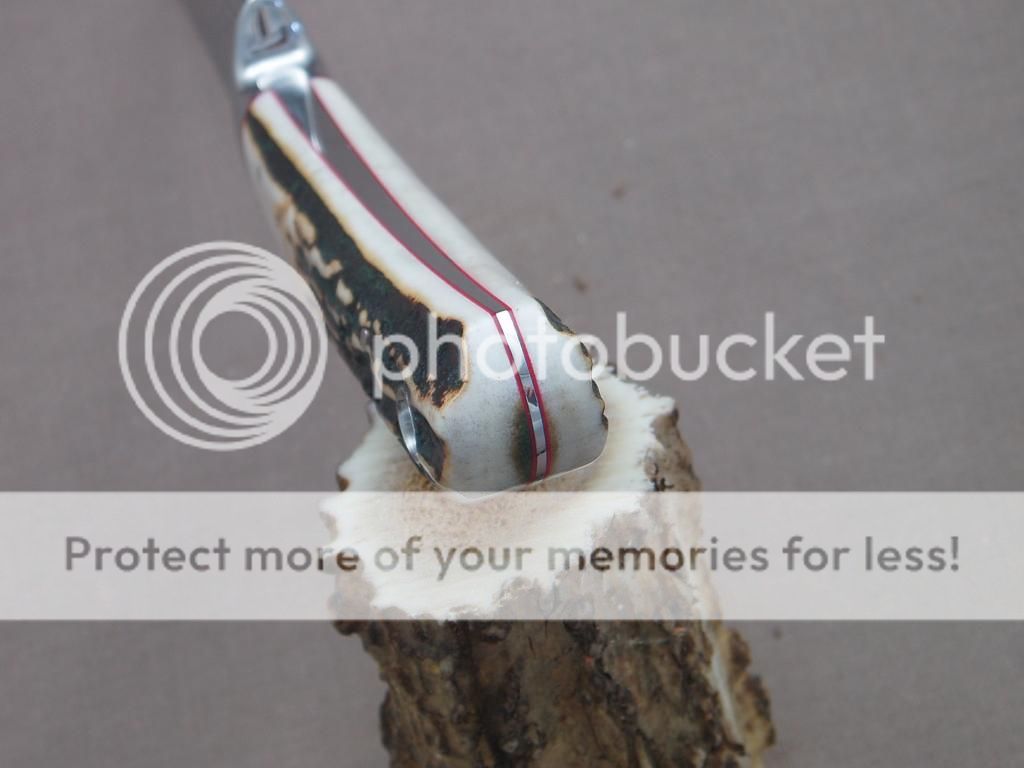

Just finished this Bird and Trout and wanted to show it. OAL 7 1/4" X 3 1/4" blade (to front of guard)
Blade is Sandvik 12c27, hollow ground, full tapered tang and 800gt hand satin finish.
Scales are Samba with red fibre liners.
Guard is 416 stainless. Pins and lanyard tube are 300 series stainless.

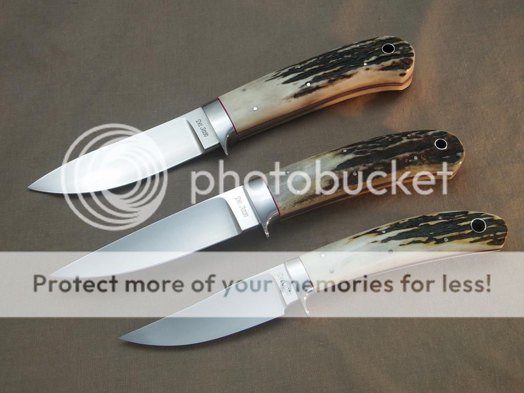

The last pic shows it grouped with a semi-skinner Hunter and a utility Hunter. Any and all comments welcome, hope you like it.
Now here's a useful post. A student's coming over to my shop this afternoon. I can show him a photo of what a full tapered tang knife ought to look like.
Fine job, Peter, on all three. The little Bird and Trout's my favorite. Such a nice blade.

I still remember 4-5 yrs ago when i first started out Pete telling me" If ya gonna taper a tang, then taper it". Certainly makes them feel good as well as look good. Very nice Pete.

Liked the first two pictures, fell in love at the third photo.
If I were a fish, you'd of had me!

Thanks and glad you like it John. My advice to your student re tapers would be to finish them off on a disk grinder. Only way I have found to get them truly flat.

All 3 are beautiful examples of your work Peter. I think being a "forged blades with dropped edges guy", my eye gravitates toward the bird and trout the most... but all 3 are fantastic.
