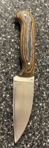

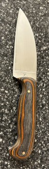

I wanted a bird of prey series with wharncliff blade and bird’s beak handle. All the Hawks/Eagles pretty are taken: Osprey, Kestral, Condor etc. So, I decided, we’ll honor the Owl. Barn Owl is the medium range blade.
80CrV2: OAL 8.25”: Blade 4”
Rc~ 59 by Paul Bos
Dymalux Ember Glow handles : .25” Brass pins: West System GFlex epoxy
I used EDM sticks for the first time cleaning up the blade and I also put an AppleSeed/Convex edge to test out. I’m thinking I’ll have to break out the leather and stick up a simple pouch sheath for this one.
