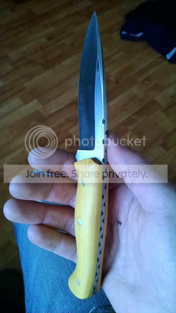

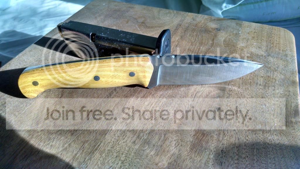

I made this knife for a good friend's birthday. What good gifts knives make. I'm fairly new to this stuff, but getting better with every blade. Made from the Baron's 1084, partial flat grind (320 grit machine finish) with osage orange handle and simple filework on the spine. 4 inch blade, 8-3/8 inch OAL. It is what it is and is in the mail, but let me know of anything I could change or do different in the future. Thanks! and hopefully these links work

One thing you should do is space your pins an equal distance from each other.

Thanks for the comments, everyone! This was knife #8, there are 2 more in this little batch, they should be done the week.
I will agree with you on this. Which brings me to a question. If the knife has a lanyard hole, can you get away with grouping the two front pins closer together? The other two in the batch have lanyard holes and I spaced the pins the same way because I kinda liked the look. But this one is just three pins and I agree, it looks off.
A lanyard tube acts as a pin. Spacing the tube and pins equally gives the knife symmetry.
